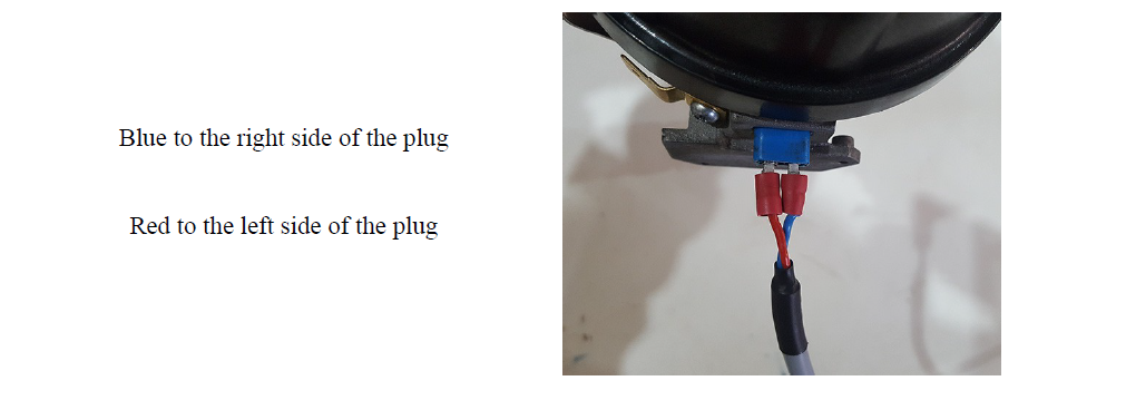

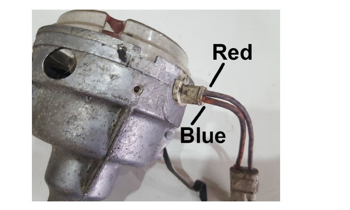

Well I decided to do multiple things at once and then made a mistake. I went to re-route the distributor amplifier from the new distributor I bought and Now I can't figure out which colored wire goes where on the distributor
EDIT:
My internet sleuthing answered my own question
New Style with Amp on Distributor
Old style with Amp behind Left Headlight
