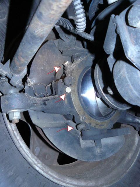

Old Dec 23, 2011 | 10:49 PM
Posts: 16,322
From: Savannah Georgia
Here's mine. Top arrow is fill, center arrow is level check, bottom arrow is drain and it is a very small screw. IMHO overfill is a non-issue. Oil, slurry of oil and grease, or grease (Red and Tacky, Green Grease, etc.) - it's all good and better than a leaked down dry one.

Old Dec 26, 2011 | 06:39 PM
Danny Lee 97 Disco's Avatar
Joined: Mar 2010
Posts: 5,584
Likes: 7
From: Pittsburgh PA suburbs.
Mine is just like Savannah's. The first time I serviced it, there was very little in it. I drained it and filled with the 85-90W with no problems. After a couple of years, I drained that and used the 0ne-shot from Rovah Farms, about half of what AB charges.
