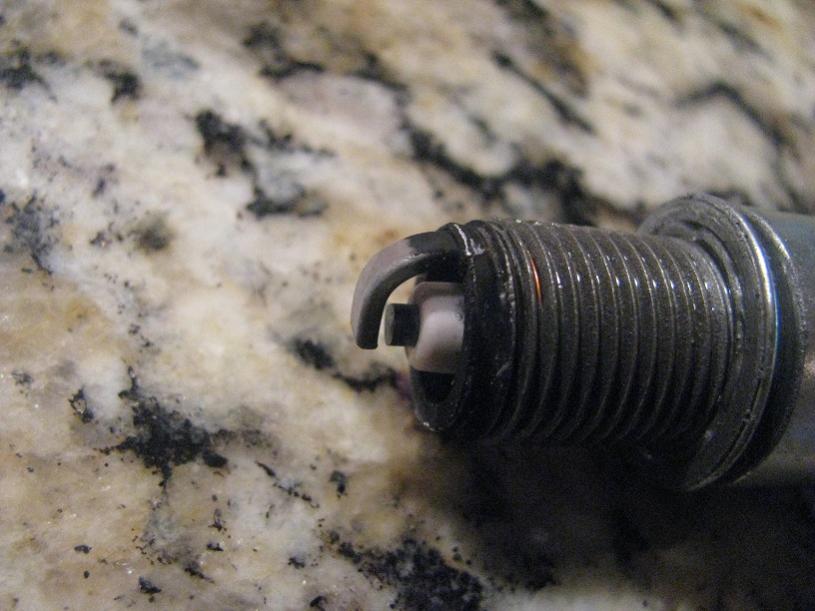

Also, instead of the plugs being all black, they look like this after the trip.

WELL IT IS LOOKING MUCH BETTER (plug wise)!
My exhaust always seems fairly moist, I can often see the vapor condensate like a slight vapor trail sitting still, but I do not consider it to be smoke!
Maybe everything needed some time and cycles on it to start to run properly.
