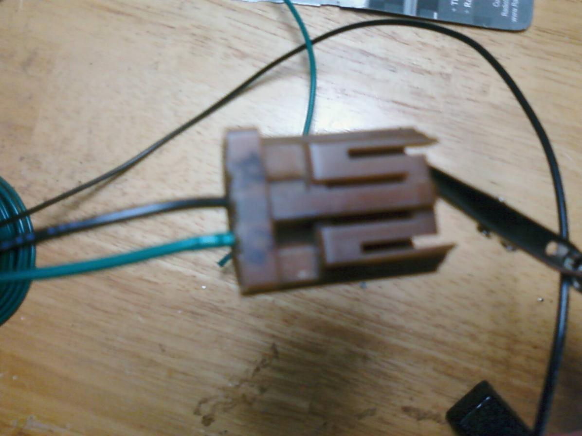

well this is what I found today.....ran a test that I believed would let me know if ecm was bad...... disconnected Camshaft sensor and tested for voltage between 1 and 3 pins on the pigtail connector while helper tried to start. as always ....got the same jumpy voltage 12v/9v/10v/5v figured ecm was sending signal to the sensor so it must be at least ALIVE also tested between , 2 & 3 same voltage jumps and between 1&2 jumpy but lower

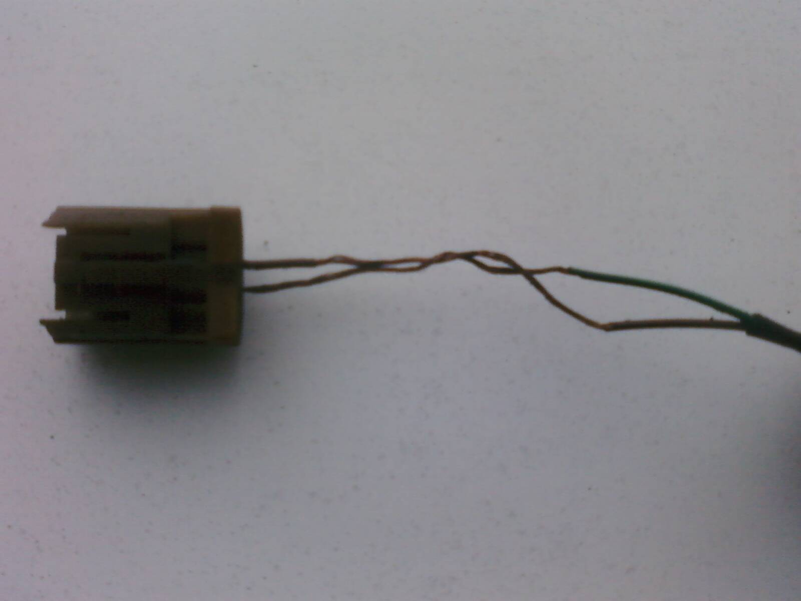

moved on to crankshaft...did I mention I cleaned the underside the day before ...wow it looks different.... now with decent flashlight and after remove fiberglass from my eyes I see.............................................!! !!
crankshaft sensor pigtail had lost all the insulation and the 2 wires were wrapped around one another---
The previous owner had replaced this item trying to start and probably twisted it the wires , they were very brittle, I could not figure out how to get that fiberglass cover off tore it ...probably regret this ay?

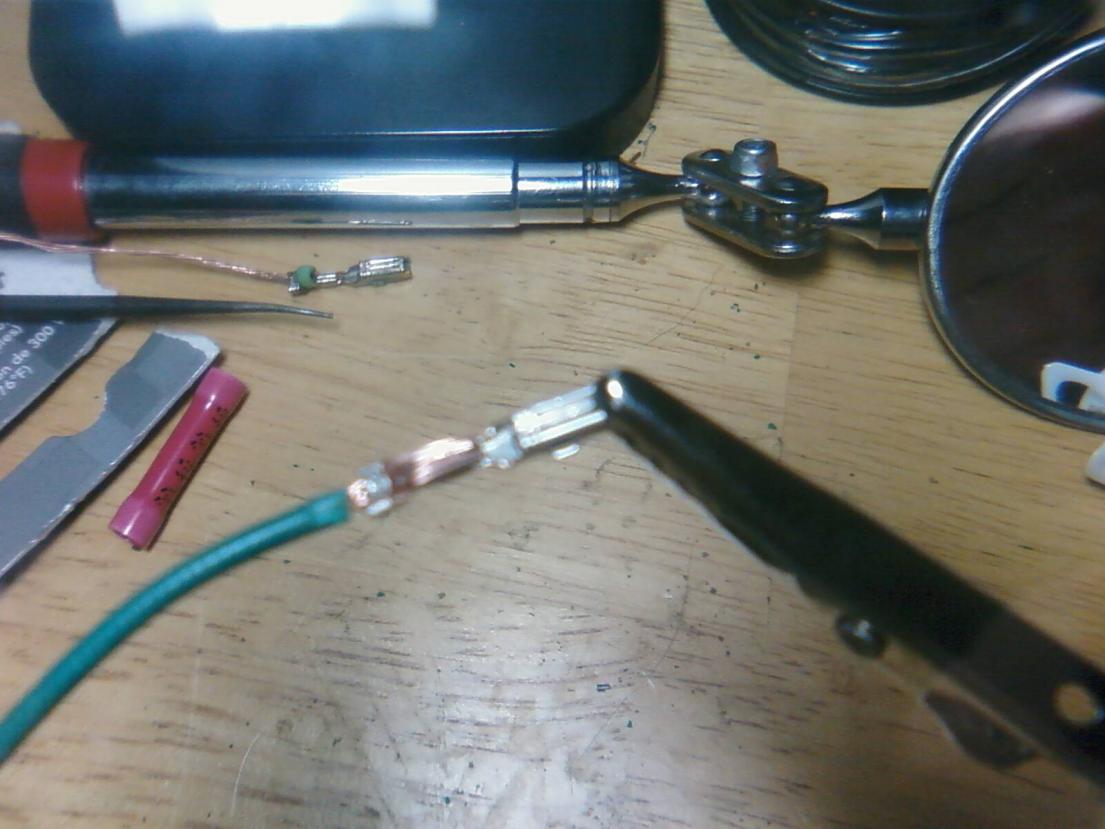

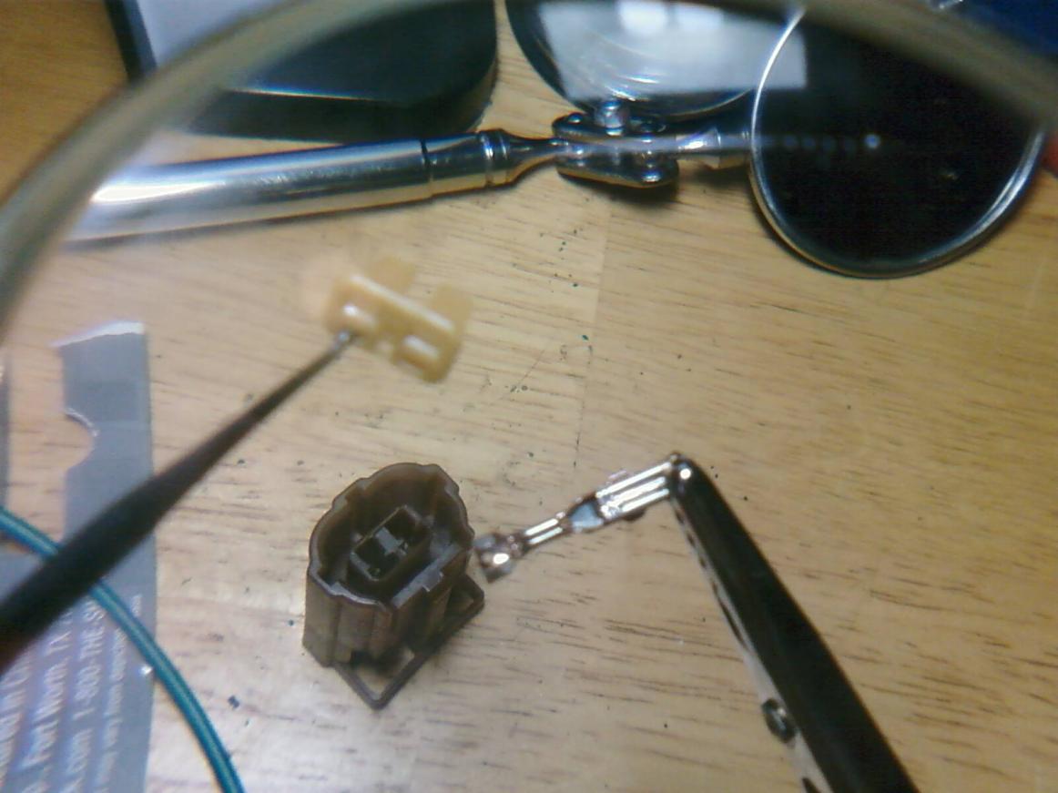

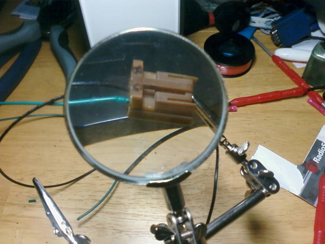

anyway cut the connector pigtail off about 6 inches back and proceeded to try to find the connector I had seen the night before while watching ehow and crap on how to test your cam/craftshaft testers and how they work yadayada I thought it was a ford or olds anyway ... thought well surely I would find it for a ford in the connectors book....called rovers north , 2.5 hours later gave up on new connector (really wanted that new NOT brittle plastic tho) wasnt too bad though so went to the shack (radio that is )
got some wire and solder and a new solder gun that spiffy magna glass is from the Harbor and proceeded to rewire the connector the pics if they made it are these ...and my yucky plugs ...
try it out tomorrow after shrink wraping and heat barrier sleeve added
