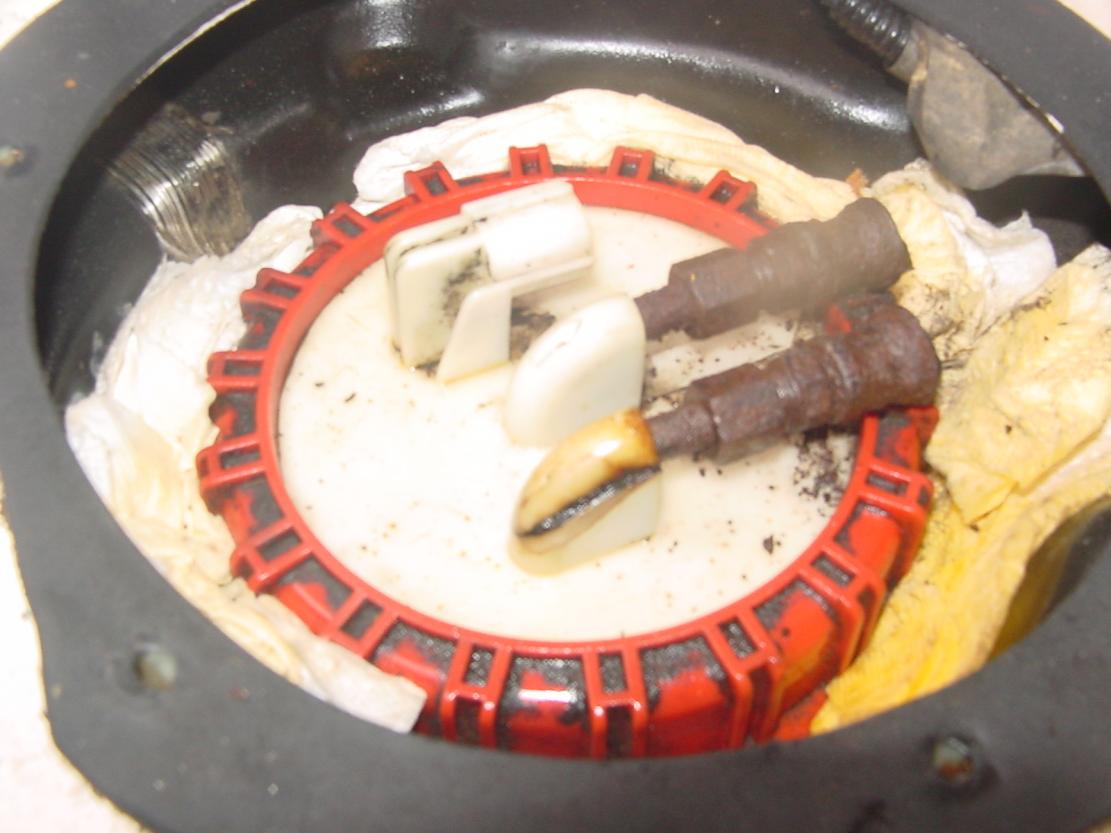

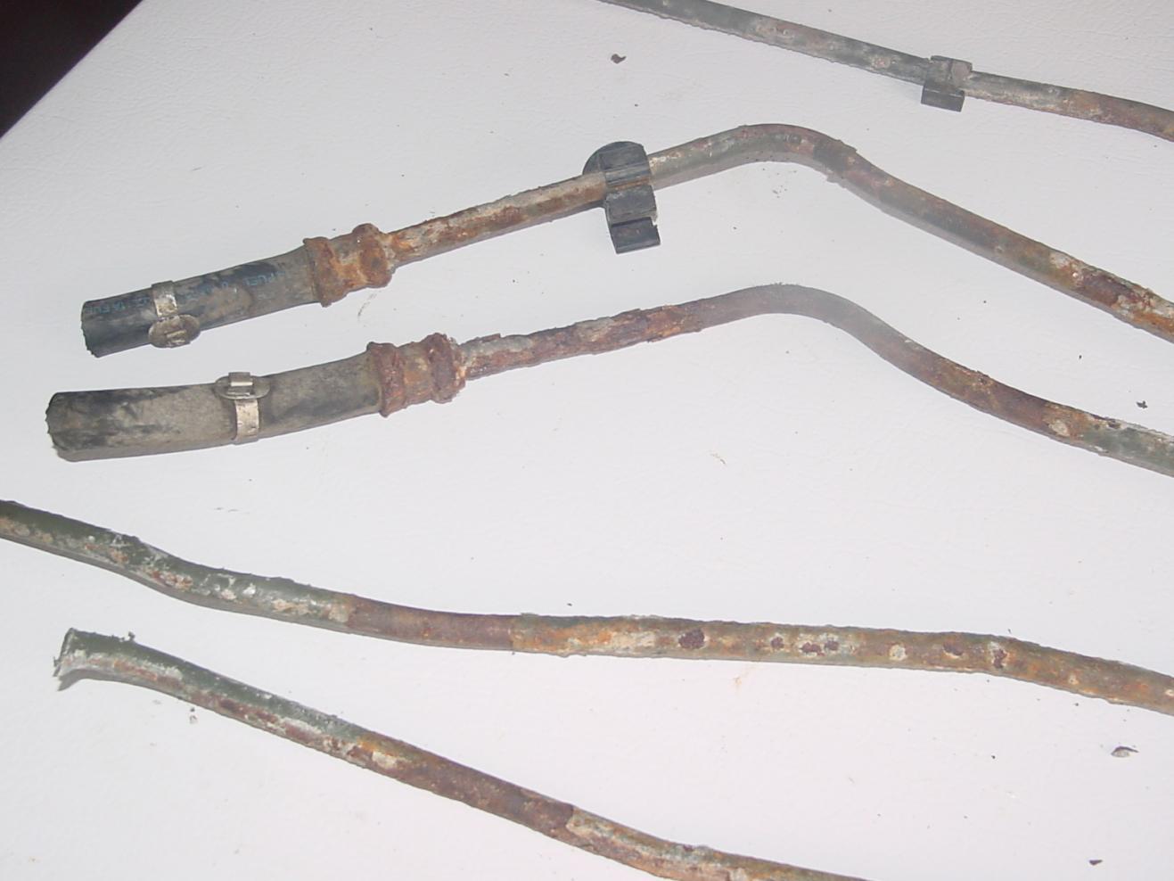

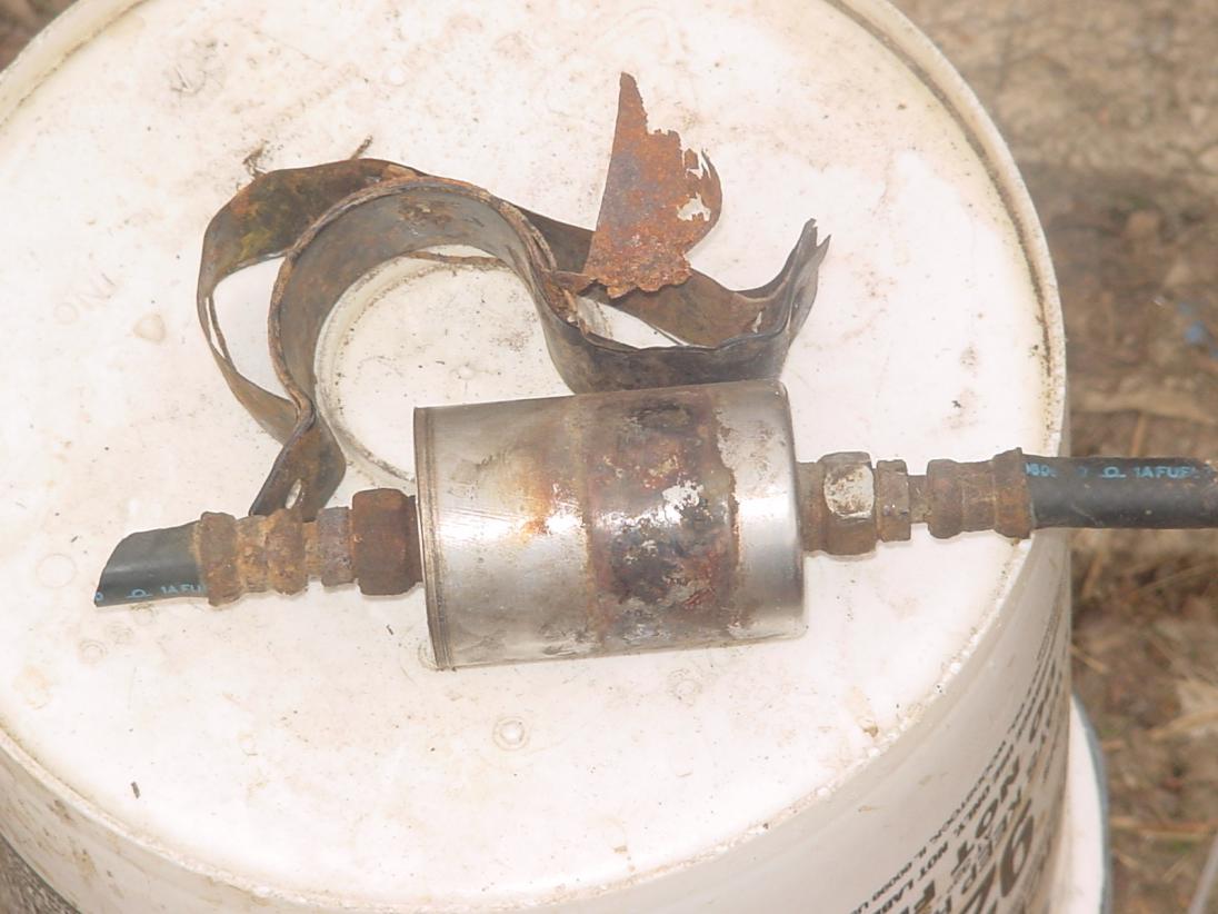

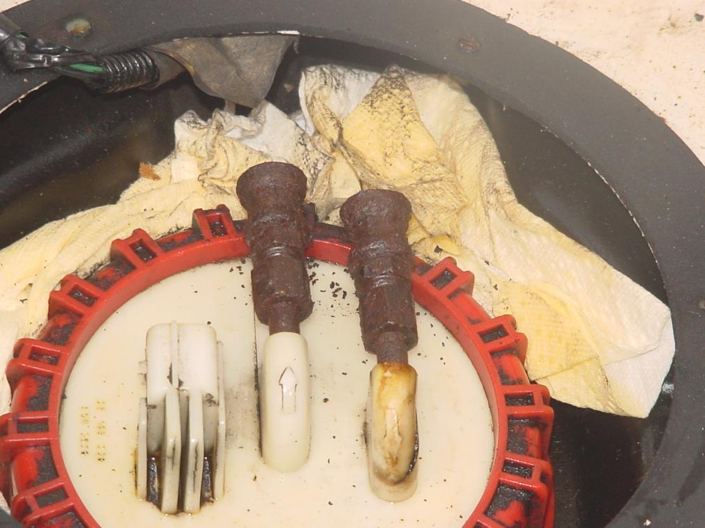

Here's some pics for some of you new people to see what I had to deal with on my fuel pump and fuel line problems.
I was in the process of attempting to remove and replace my starter, when I lifted the fuel lines out of their clamps on the frame, I discovered the old fuel lines were so corroded that merely lifting them from the clamps resulted in multiple leaks. The lines and clamps had corroded so badly that the metals had suffered molecular migration such that the two surfaces were physically bonded together and the lines no longer had any pressure integrity.
Look at the advanced state of corrosion between the filter body and it's clamp. The clamp was mostly gone and the filter body developed a pinhole spraying gasoline right out the side of the filter body. The clamps for each fuel line had become one with the body of the tubing. The tubing was so corroded it readily trwisted apart with very little effort. That's the state of things I found merely trying to change the starter.
So one important thing to realize on an older D1 that you just bought is that even a simple job can turn into a major difugulty in a big hurry. Be prepared for the unexpected any time you start to do anything to it until you have worked your way completely thru it.

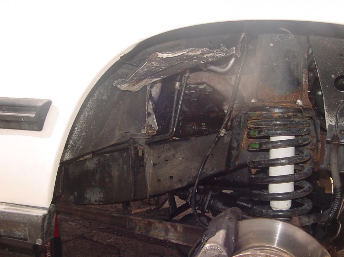

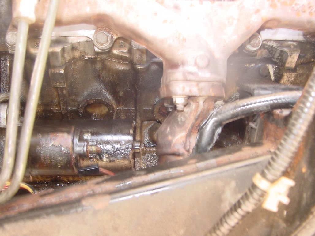

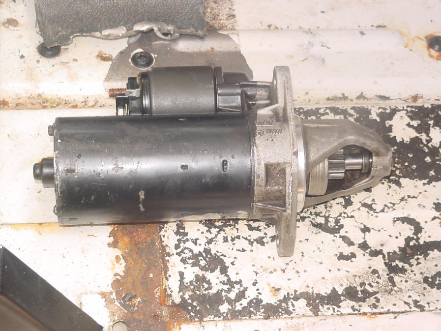

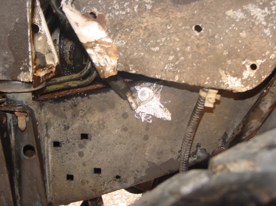

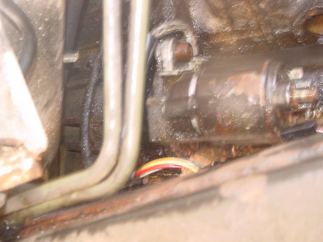

Here's some more good ones related to the starter ground. To improve ease of access to the starter I took the liberty of using a pair of aviation tin snips and cutting the inner fender wall up along the seam and merely rolling it up an out of the way to have a direct view of the starter. When I lifted the fuel lines that reside there from their clamps, I found them to be totally corroded. The second picture shows my new ground connection to the frame. I used a dremel deburring tip to abrade the frame to bare metal for an intimate ground lug connection.
Many of you may think I butchered the inner fender wall, but I like the direct access it provides to both the starter and the exhaust manifold to y-pipe flange which required a new gasket to take care of an exhaust leak. The last pic is the replacement starter I bought that is now sitting on my garage shelf since the original problem was the ground, not a bad starter.
I started off trying to replace the starter and ended up replacing the entire fuel lines from tank to engine bay.
Upon completion, the fender wall folded neatly back into place. Redneck engineering at it's finest.
