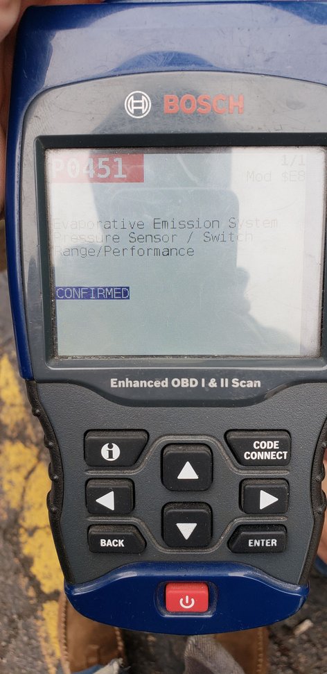

I actually found one code. Lol let me know what you think.

12v purple/white wire. The green black and red connection is sending unit voltage and should be 5v (which it is) I've also read there is a pressure switch built into the top flange of the fuel pump assembly. True?
