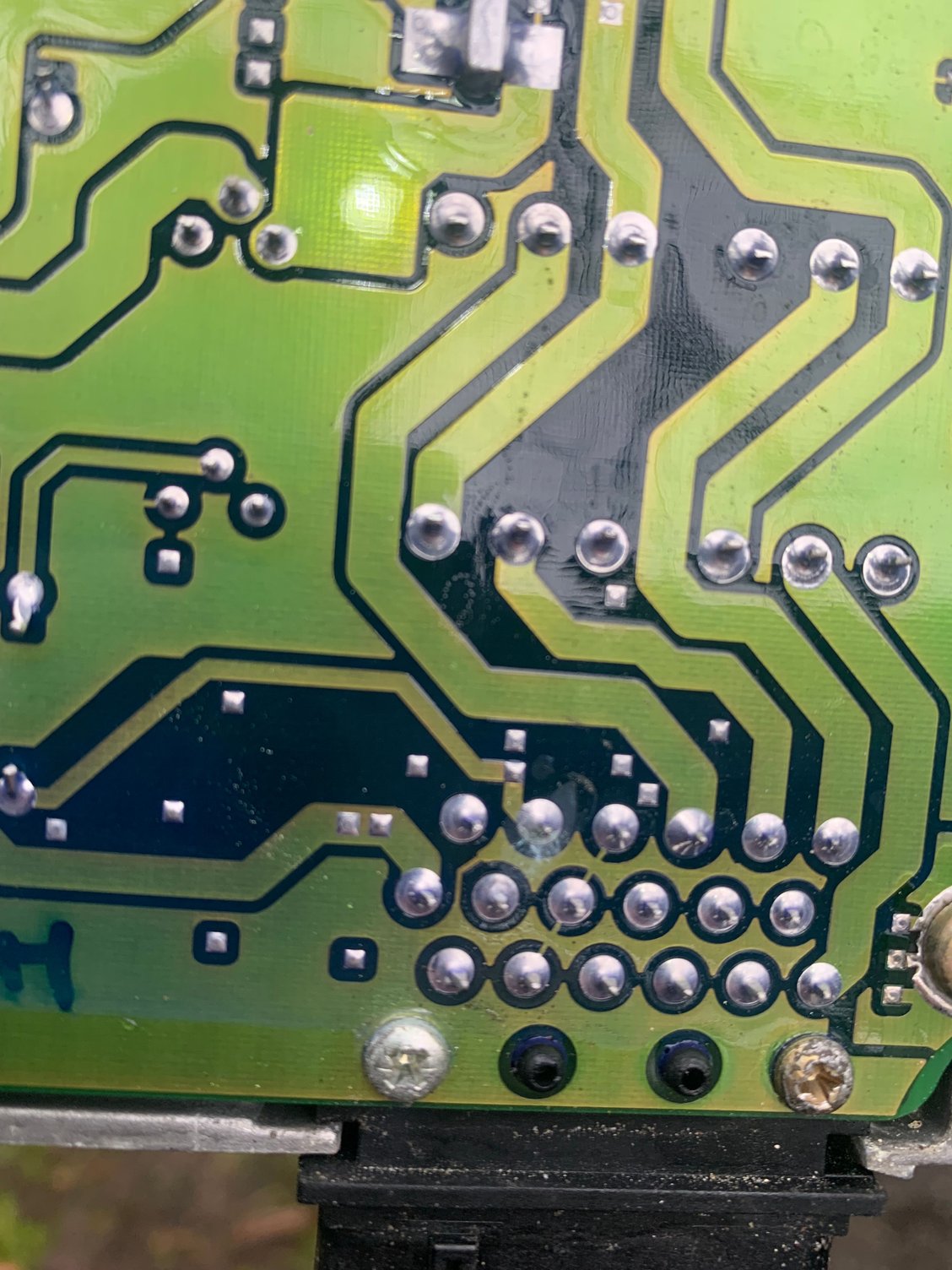

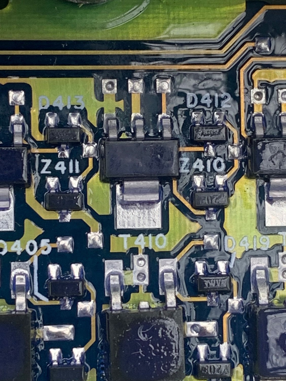

It is a 1999 disco1 or late 98 Disco1. J pulled my ecu apart today when I realized that I had no check engine light on when I turned the key on.
I found a couple spots of corrosion inside on the circuit boards. I have a new one coming hopefully later today or tomorrow.
