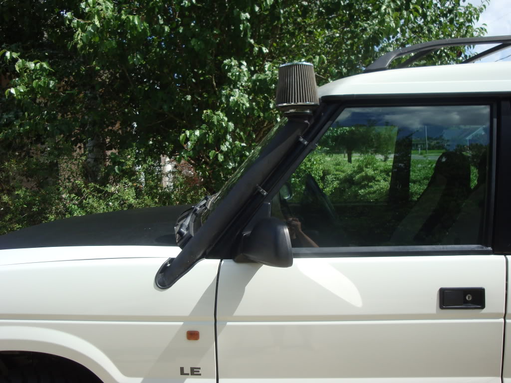

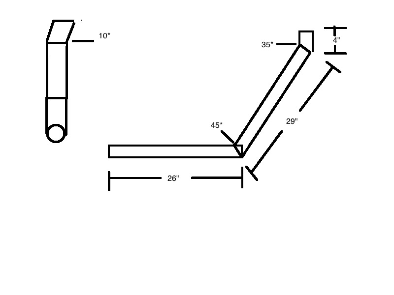

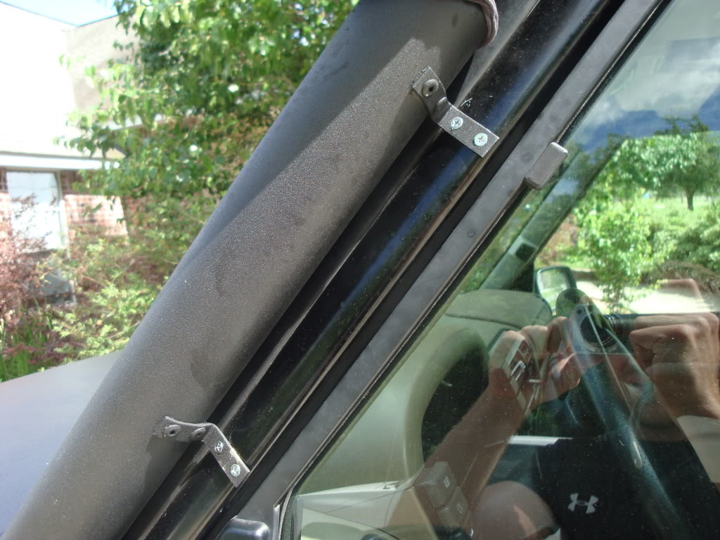

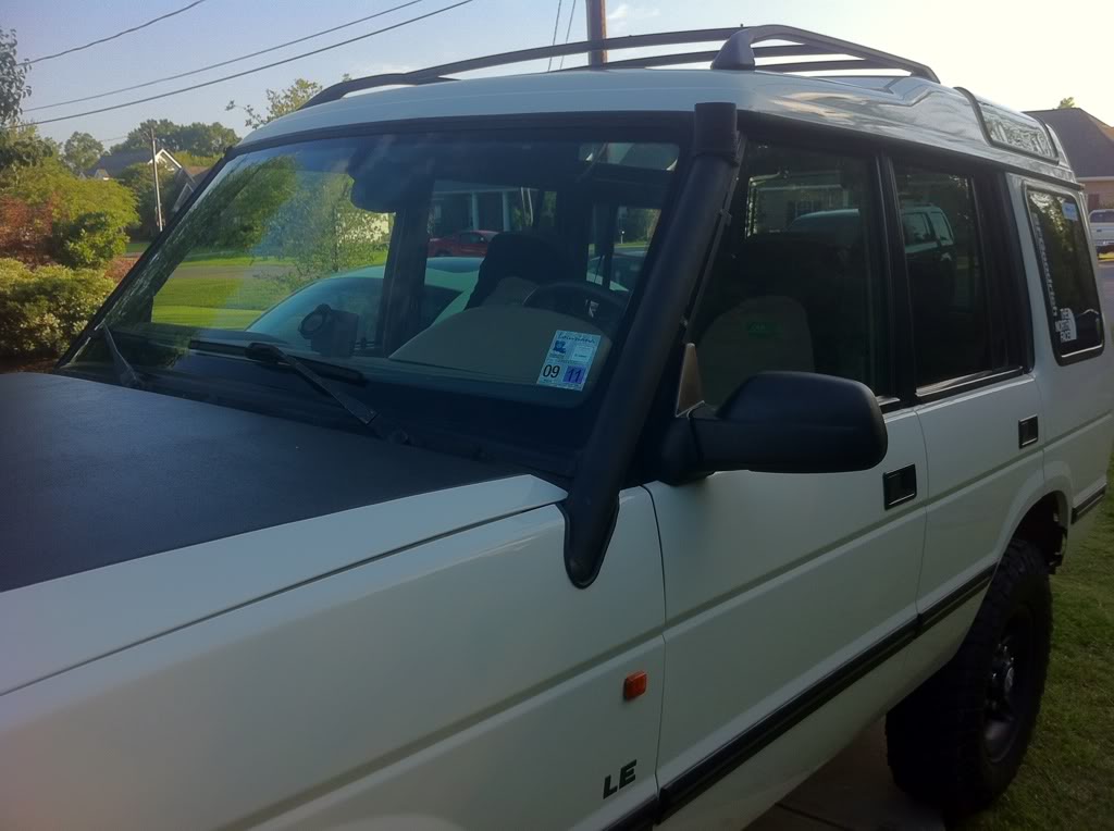

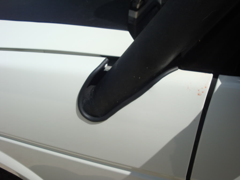

i used dryer duct, worked perfectly, scangauge showed definite decrease in intake temp but no power or mpg increase
i made my snorkle for what 30$ and it looked damn good. if you look you can find my measurements, i just brought the paper to a muffler shop and bam.
there i found it for you, dont mind the temp pre cleaner..
and then i sunk her
