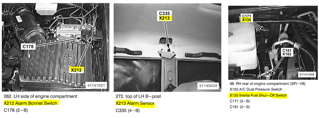

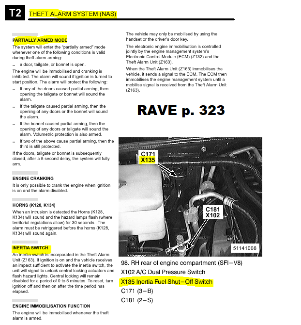

Here are some pages from RAVE related to the Alarm for components to check. Should help get you started.
Also the circuit schematics start on page 326-336 of the ETM (97-99) T2-Theft Alarm System(NAS). If you need to see specific pages and don't have RAVE just post up.
