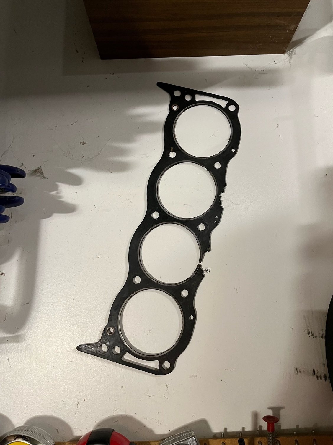

Sorry guys I was thinking I had already posted the solution to this one already.
Sadly, that vehicle is long gone. I sold it several years ago to a guy and then not too long ago I saw an ad on craigslist with it pictured, but the guy was selling parts off of it. Apparently it must have gone to the crusher. I really miss that truck too!
Proudly, I still have this little trophy hanging from the garage wall:
It was an exhaust leak out of the head gasket. You can see the part around the cylinder where there is a completely open gap (right next to the drywall screw on my wall). that thing had deteriorated to the point where exhaust was just shooting out the side of the engine... Obviously I did both head gaskets at the same time but the other side was fine. This was the passenger side one.
