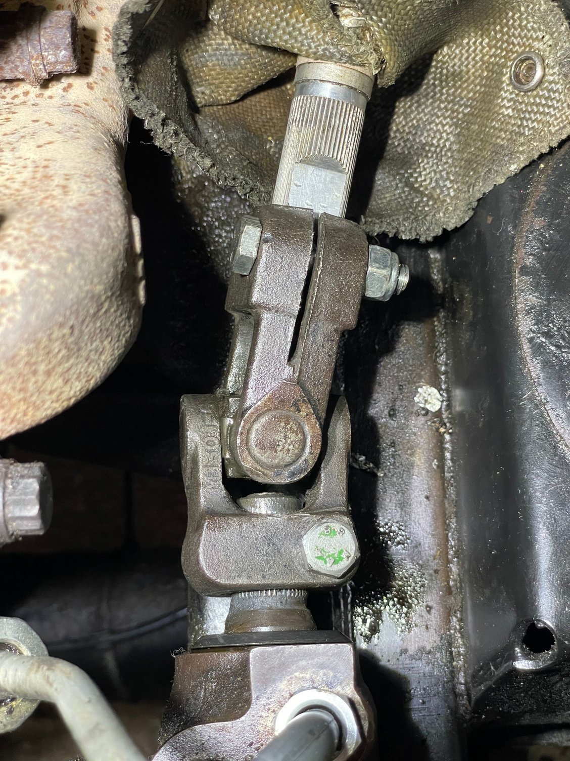

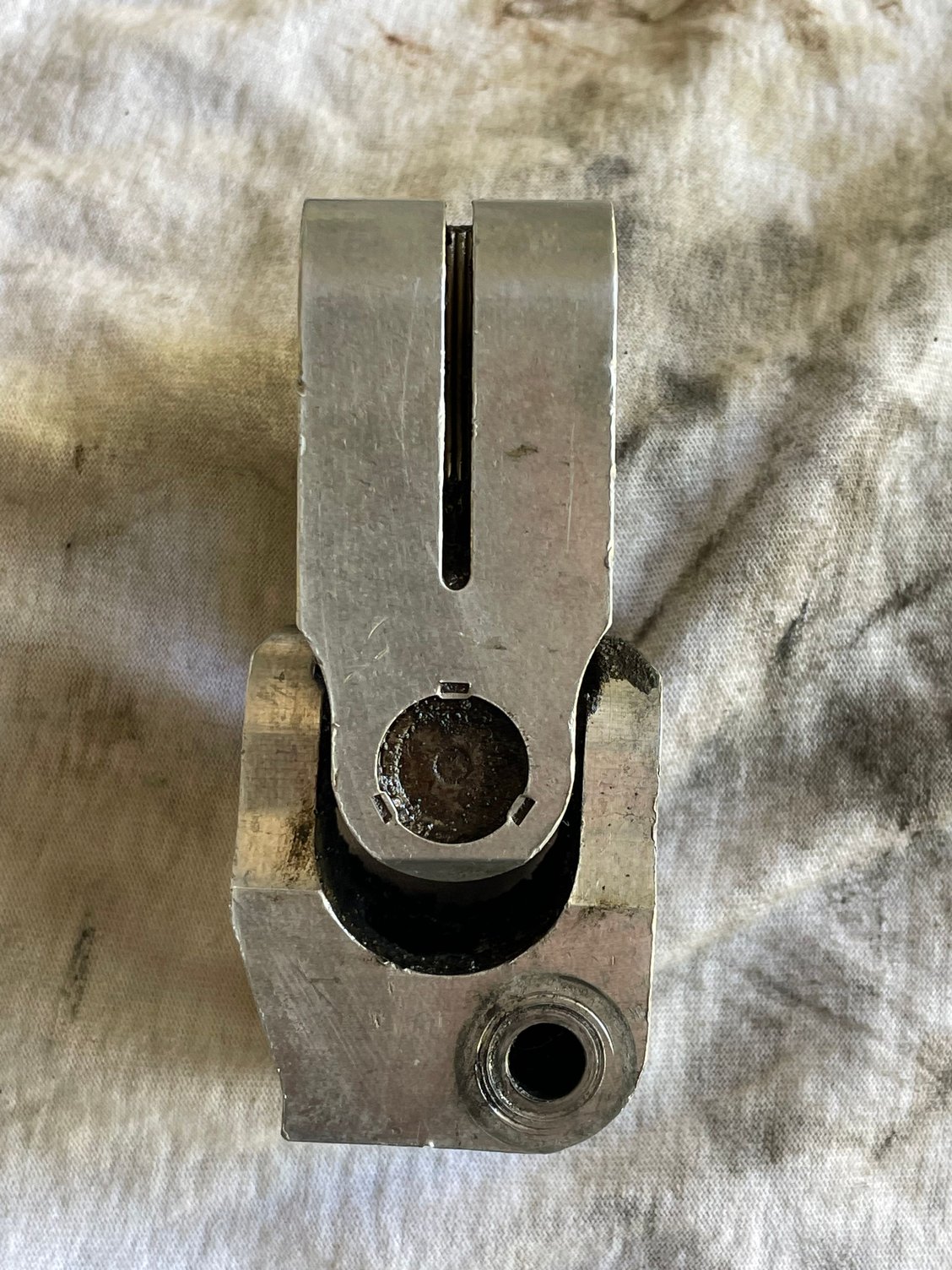

Default Found the problem to the loose steering
Turns out, the issue with the play in the steering wheel was cause by the lower steering link that connects the steering shaft to the steering box. It had a alloy one and when I bought the Disco the guy gave me what looked to be an old OEM one.
I wondered why till I grabbed the steering shaft and saw it move back and forth before engaging the splined shaft out of the steering box. Turns out the splined female end was wallowed.
This was the problem all along.
Also, I realized that whoever installed the h/d alloy one didn’t bother to center the steering wheel. I fixed two problems by installing the factory coupler.

that is the factory coupler

So this one is aftermarket?

Nice to hear a happy ending. Good lesson in persistent troubleshooting, paying attention to basics, and using all your "clues". Seems that's how it is with Discos.

the steel coupler is off a non airbag range rover classic
