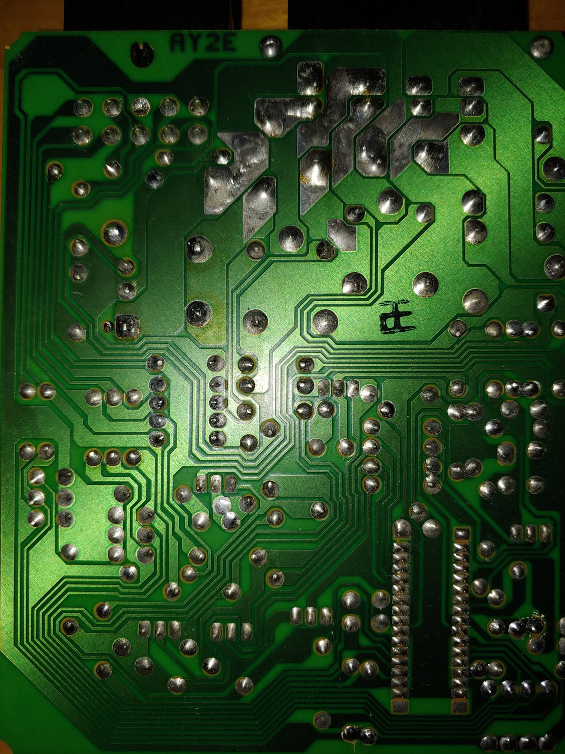

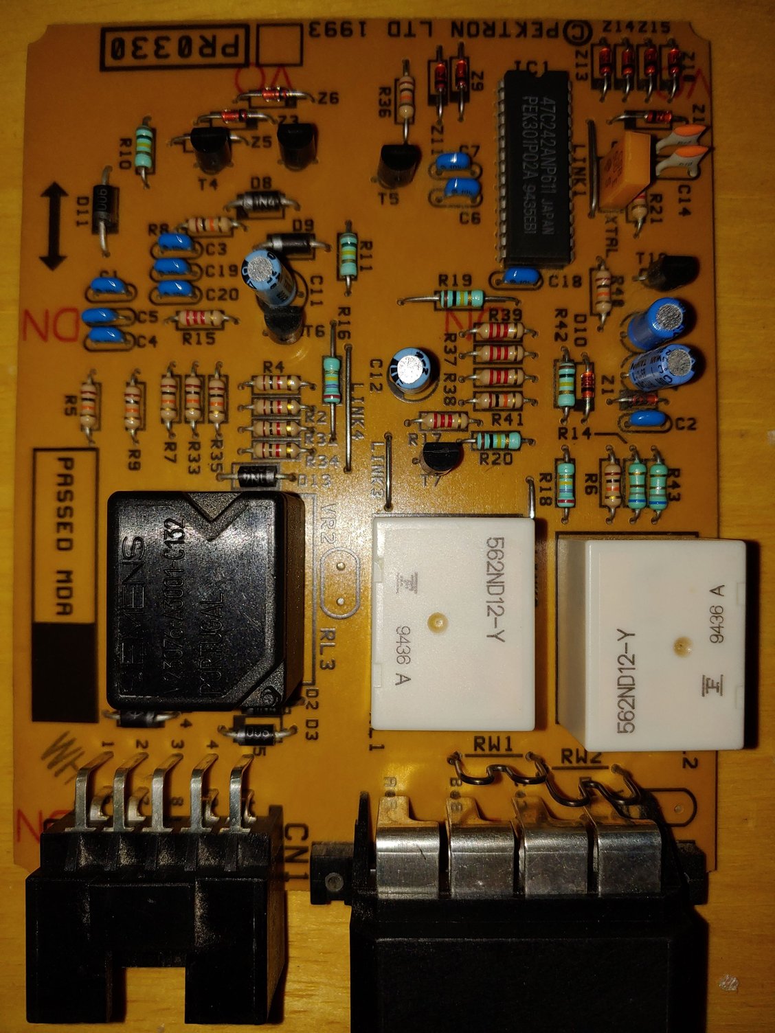

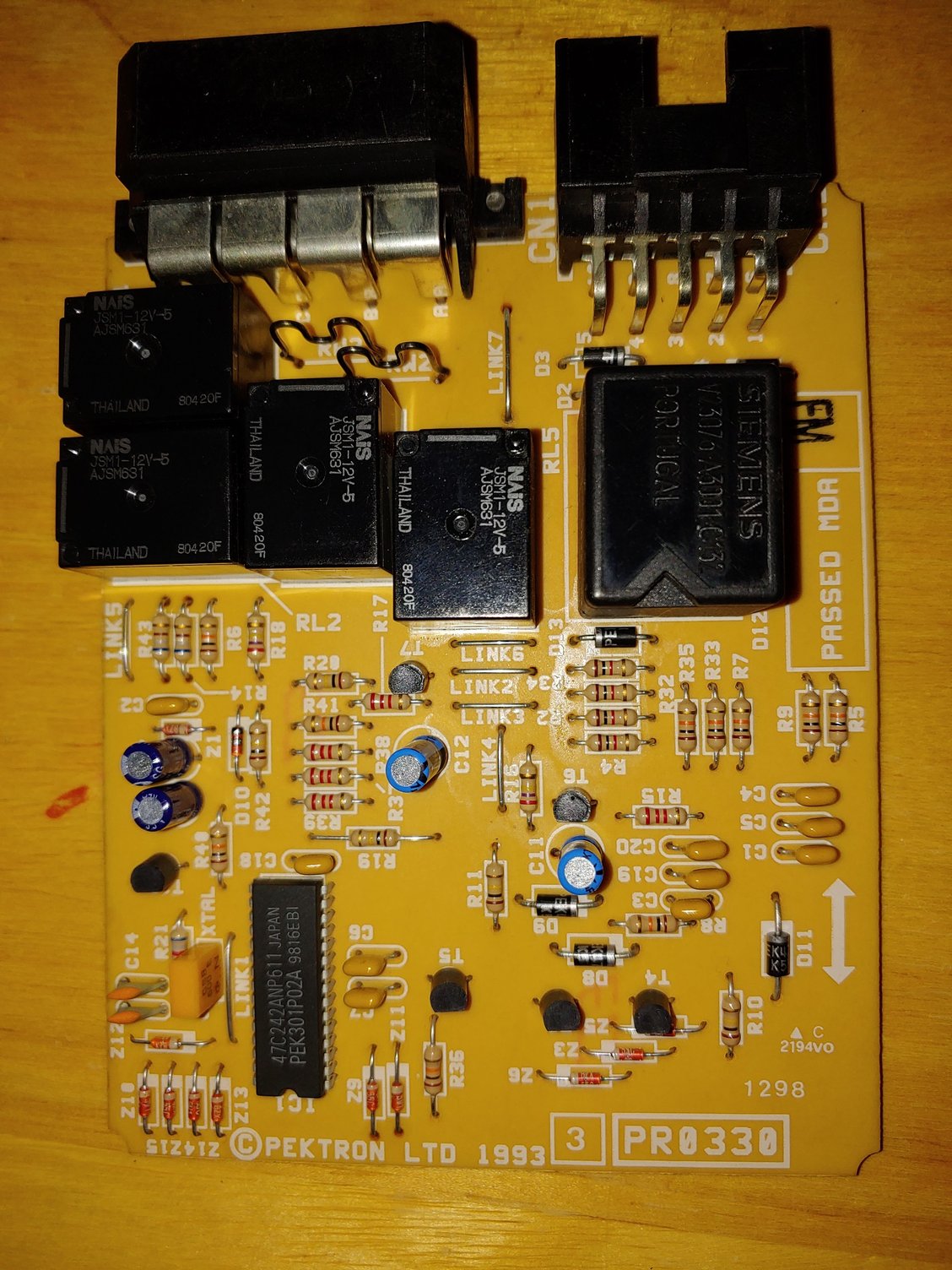

So I dug a bit more into it after checking out the WLift ECU soldering and testing where I had someone better at soldering than me (my Mom) fix the parts that looked iffy. Put the board back in, hooked up power and the windows didn't work. Then I turned the key on and windows all worked as they should, turn key off, and took it out, but windows still worked even with the doors open and no key in ignition. That confused me quite a bit actually as it didn't work when power was first restored, but then went back to working with key off. So I went over and grabbed the one out of my Mom's 95 V8i, and hooked power up once again, it acted the same, worked with all windows with key on. Turn key off and take key out, doors open, and windows don't go down or up with switches, as they shouldn't.
So I got to thinking perhaps something is a bit off on the board I have, so I took them both and compared them. Other than the obvious differences with parts on the board, the two white blocks rather than 4 smaller black ones, and colors and lengths on some of the resistors I honestly couldn't see a huge difference or what it might be. So any help would be greatly appreciated, or if you might not know, perhaps could direct someone or direct me to someone who possibly could. I am at a loss here, and rather confused. Also don't have a part # for the WLift ECU from my mom's as weather didn't permit me to pull the whole group that the WLift ECU is a part of, just allowed me to pull the board out of it's housing. Left pictures big so that details in difference might be easier to spot. Have a great weekend.
Top of WLift ECU from my 96 SD
Bottom of WLift ECU from my 96 SD
Top of WLift ECU from my mom's 95 V8i
Bottom of WLift ECU from my mom's 95 V8i

Modern cars have a feature that the windows can be operated after the key is turned off for some time until the timer times out or a door is opened. Maybe the door open feature was added at some point. These design details are always being tweaked. Gives engineers something to do. Maybe see if the windows stop working after some time.
