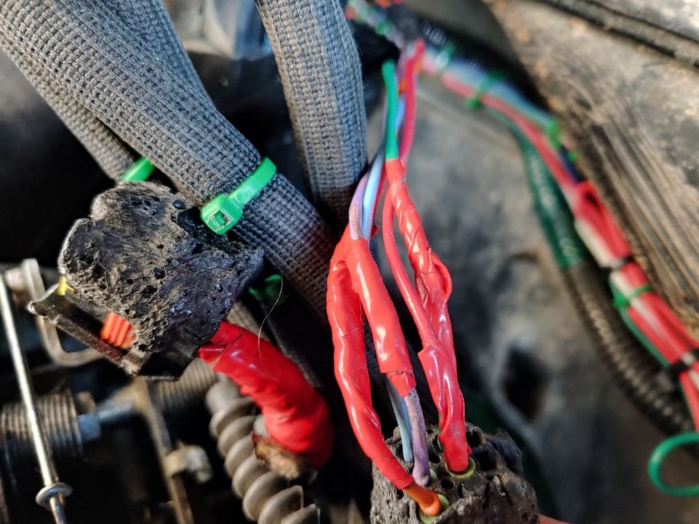

So I went up to do the test, as had to deal with replacing a bathroom faucet Sat., I had to unplug all the plug wires so I could move the coil pack to where I could get to them with the test light. Had my mother as the key turner, and when cranking the light did blink barely, but something stranger happened, the coils were arcing slightly. So I plugged the plug wires back in with it sitting on top the plenum/throttle body cover, and went to do the test again. First crank, prob 1 second after starting it fired right up so I had her shut it off, and proceeded to test each wire, shutting it off when it was actually starting. Well the light blinked barely on each, and it started up on each test also. I am not sure as to what is up other than perhaps there is a wire that is partly broken/etc where the coil pack plugs in, and it is possible that when installing or uninstalling the pack it sometimes gets moved to where it won't work correctly. Honestly never did get around to really fixing where it got partly melted from when it caught fire, so wouldn't honestly surprise me if something was wonky right there, and that was all it was. Anyway going to include the pics I took today of the coil pack wires, and the plug on the loom. I did find a plug that is just like it on the donor loom I have but wire colors are different, as they are all white with colored stripes on them, but honestly not even sure what model the donor came off of. All I do know is it's got a MFR for the fuel pump and stuff like my Disco(96) has, but my mothers (95) doesn't.

All right! That's progress. Good for you keeping after it!
Barely blinking light is normal because the pulses are really short time.

Cool, at least I think we have found the problem, now to try to see if I can't get it fixed. I did notice when I brought the pack down to try to fix wires/plug that there was a bit of black stuff down in the coils where wires go. So I took some q tips and 91% iso and cleaned em out. May not get it all done today as I have to mess with starter on Frontier, but will let ya know . Also should prob change title from mystery battery drain, to mystery battery drain and not wanting to fire :P.

Smile Information Update
So I went up and took the tape off the loom end for the coil pack wiring, and it turns out the wires I didn't know what they went to cause they had same plug but were white with colored stripes are the wires that go to the coil pack on the loom side. So that will be a easy fix, and I went and checked for another plug I could use to replace the slightly melted one on on the wires that connect directly to coil pack but no luck. Was looking online and found a few used kinda rusty looking coil packs on ebay for under $50, and they had wires. So I picked the best looking one for $40 bucks and bought it. So it will be a little bit before it gets here, and then I can swap the wires out. Will let y'all know when it gets here and such.

Thanks, though after how crap FedEx shipping was, and how bleh the seller was to deal with I think I would have been better off paying the extra 10 bucks for a slightly better, and closer one :P. So I got the spare pack finally and got the wires off, put the tinned copper braiding over it, as well as the heat shield stuff tonight. Though the heat shield braiding didn't work the greatest so had to use a bit of electrical tape to keep it all in place. Weather is supposed to be off and on snow/rain for next few days so going to try for Tues. to get the new end on the engine loom soldered on, and will let y'all know how it goes.
