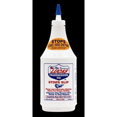

Red transmission fluid.
If you have a leak add Lucas Transmission Fluid Leak to the power steering fill container.
