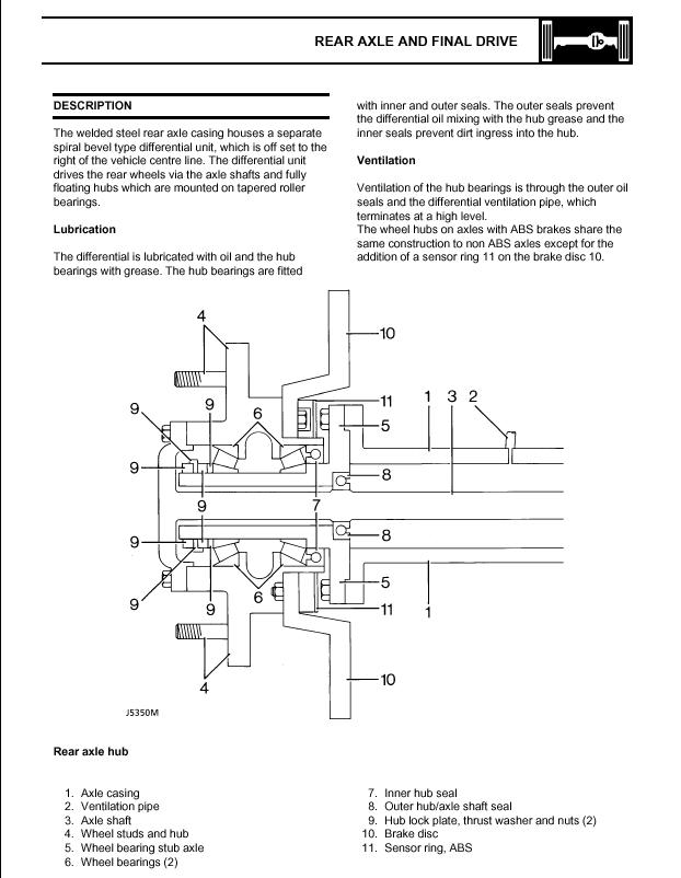

Spike is wrong here, just pack them with grease as you normally would. You will get some leakage from the swivel ***** in front if they are filled to the top with gear oil, but the mixture will not hurt anything. You should never clean and not re-pack your bearings.
If you are doing rotors, re-pack your bearings. the RTC3511 is a double lip seal that will keep more moisture out of the bearings if you wade much. It is a better seal than what the normal one is. I just used them on the front for mine. They are holding up great.

Then why is it that my bearings in my rear bub are grease free and oil soaked?
With my bad axle seal if I did not keep the diff right full then the bearings would start to squeak ever so slightly.
These bearings have been in the truck for 20,000 miles and have never been greased, when they were put in they were not greased, they are perfectly clean right now and look brand new, just soaked with oil.
When I pulled the stub axle off of the donor truck the bearings were grease AND oil soaked.
It has been explained to me by a very good mechanic that the oil comes through the axle housing through the stub axle into the hub.
The hub is sealed and there is a seal to prevent the oil from leaking between the stub axle and the hub assembly.
I do need to look at the Rave but looking at everything and taking it all apart and putting it all back together this all looks to be true.
Mixing grease and oil will not hurt anything so if bearings are greased before being put in it def wont hurt.
I am just trying to understand everything.

There is a seal between the axle and the stub. It is called an outer hub/axle shaft seal. If this seal is good, it keeps the oil from entering the stub axle. See #8 on the pic. You will not see this unless you remove the stub axle, but you will tear it if you aren't careful pulling your axle shaft out. There is something broken on your truck... Please edit your earlier post so people don't stop reading there and think they don't need to grease their bearings.
(as stated by a Rover mechanic)

I had a missing left rear seal when I first bought my rover. I bought the inner stub axle seal and cleaned and greased the bearing when I reassembled. As I interpret the rave diagram it is not supposed to have oil in the bearing area. It wears down the seal and in my case I theorized it ate the seal in the gearing assembly. While it appeared ok there was microscopic metal in my diff fluid. I have since cleaned the diff all up and added fresh oil and had no problems since. Since that seal was missing I did have a major diff oil leak right onto my left rear rotor causing a massive brake problem.

Ok, yes the bearings are supposed to be greased.
Mine are not, never have been since they were replaced 20,000 miles ago.
Here is what they look like.
I had to replace my stub axle because it had a nick in it from when the bearings were replaced the first time and it was tearing up the axle seal causing my leak.
Per the Rover shop manual they are supposed to be greased.
