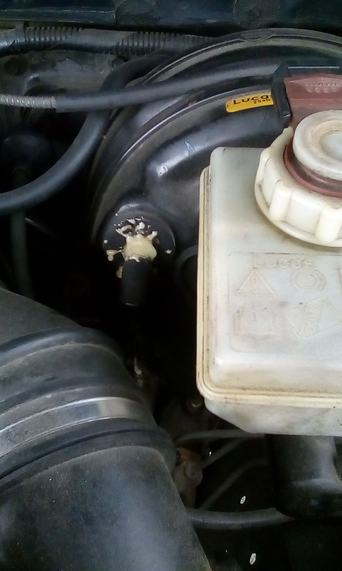

I changed my spark plugs out and now my brakes are very stiff and it can be hard to come to a fast stop. I was told I probably knocked my brake servo line a little loose. I really don't know much about cars and am clueless on the next step to take... Heres a picture of the hose
and it hooks up into here... And I'm guessing the previous owner jimmy rigged it like that and it feels slightly loose.

It looks like the nipple coming off the brake booster has cracked and was repaired with gorilla glue. Not exactly a vacuum holding material... I don't see that nipple available separately from the booster so you may end up having to replace the whole unit

Has to be one of the all-time great thread titles!
Look for part # STC780.
https://www.roversnorth.com/ProductD...=PLB173&type=0

I understand spark plugs dont effect the brakes, but that's what I was working on when that hose came loose. Now is it detrimental if I continue to drive my car around until I can get this fixed??

I can't recommend driving around with a (partially) broken brake system. Essentially you'll have non-power brakes.
