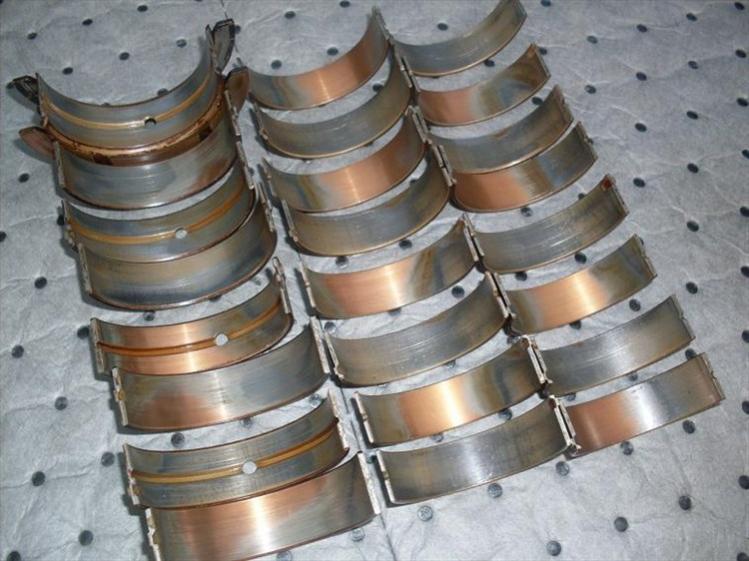

Spike may have been thinking about the carbon break valve, which is a type with a reduced neck. From his previous referenced post:
NOTE: Exhaust valves should only be replaced with new
items if the existing exhaust valves are not of the “carbonbreak”
type or the valve is damaged. Carbon-break valves
are easily identified by the reduced diameter section on the
valve stem just above the valve head (Figure 1).
I'm from the camp of get another set of heads, and look at main bearings, which can be replaced in the truck. But it depends on how long you want to keep the truck and spare cash unknown to SWMBO. Once you get started, there's oil pump, water pump, timing chain, cam, lifters, bearings, rear main seal, rings, pinning liners, even freeze plugs, and the list goes on. A fella's gotta have some time to actually drive the truck in a somewhat reckless and responsible manner.
