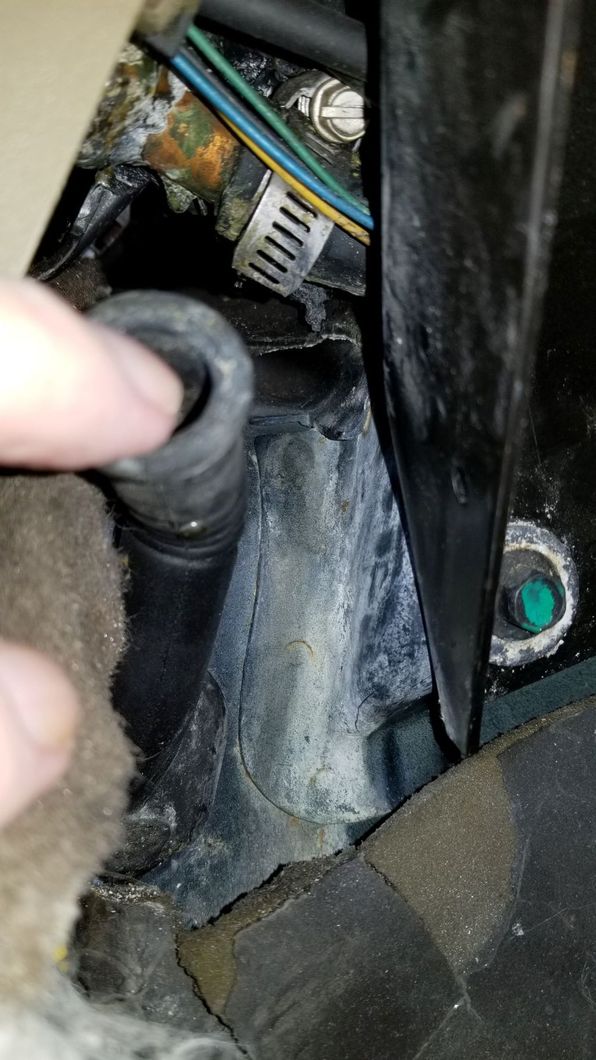

help please..water in passenger floor board for years.
You all have reported the great and easy fix when the drain is plugged
My issue is at the top.
Shop says someone jacked with the heater core and either put the wrong core in and/or cut out the box the condensation was to be collected in.
Have any of you guys replaced the heater core and do you have photos that can prove or disprove what my shop is saying?
They are telling me to just drill a hole in the floor and let the water drain but I want this project to be better than that.
Thanks
