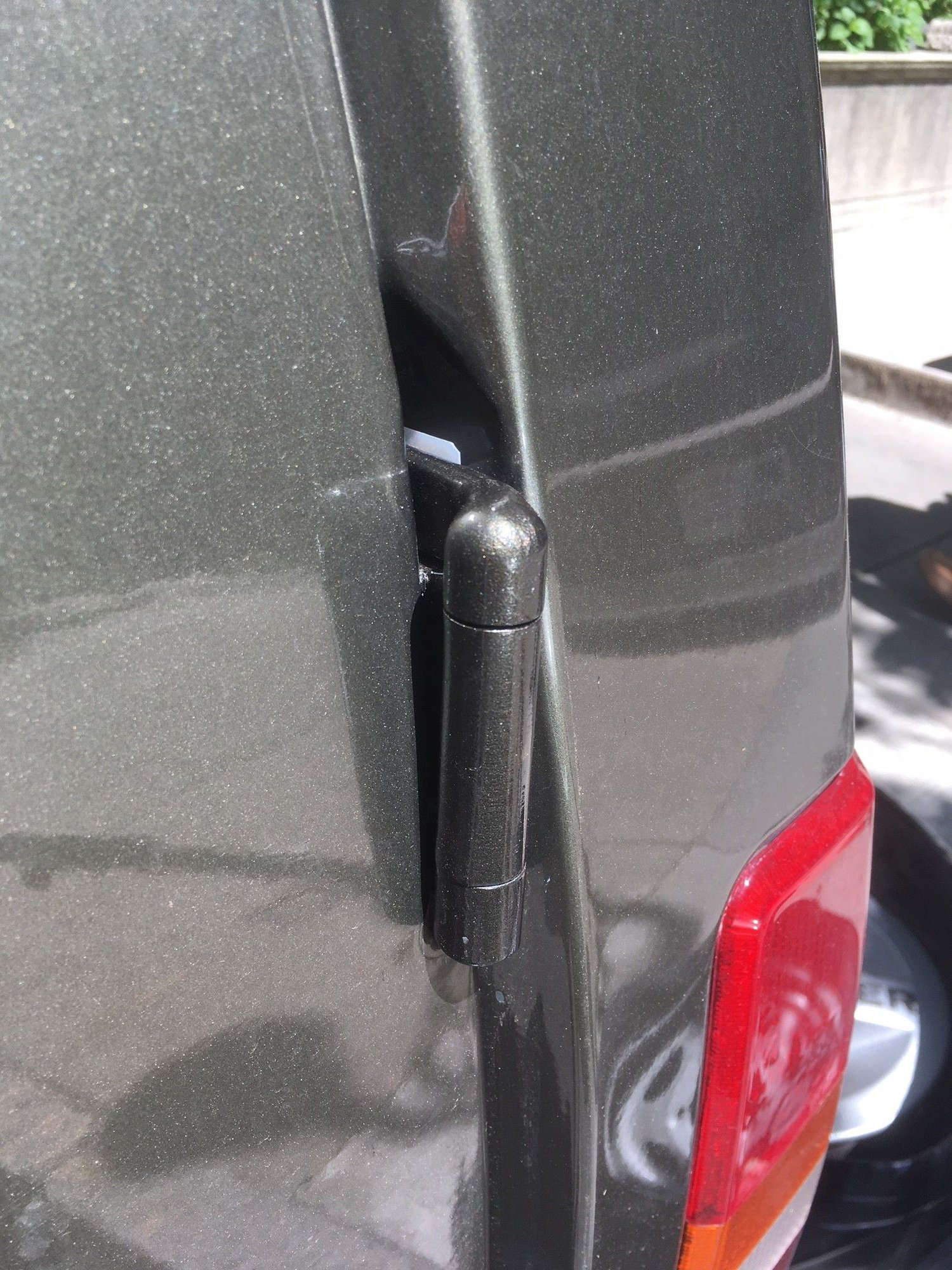

New hinges installed.
upper....

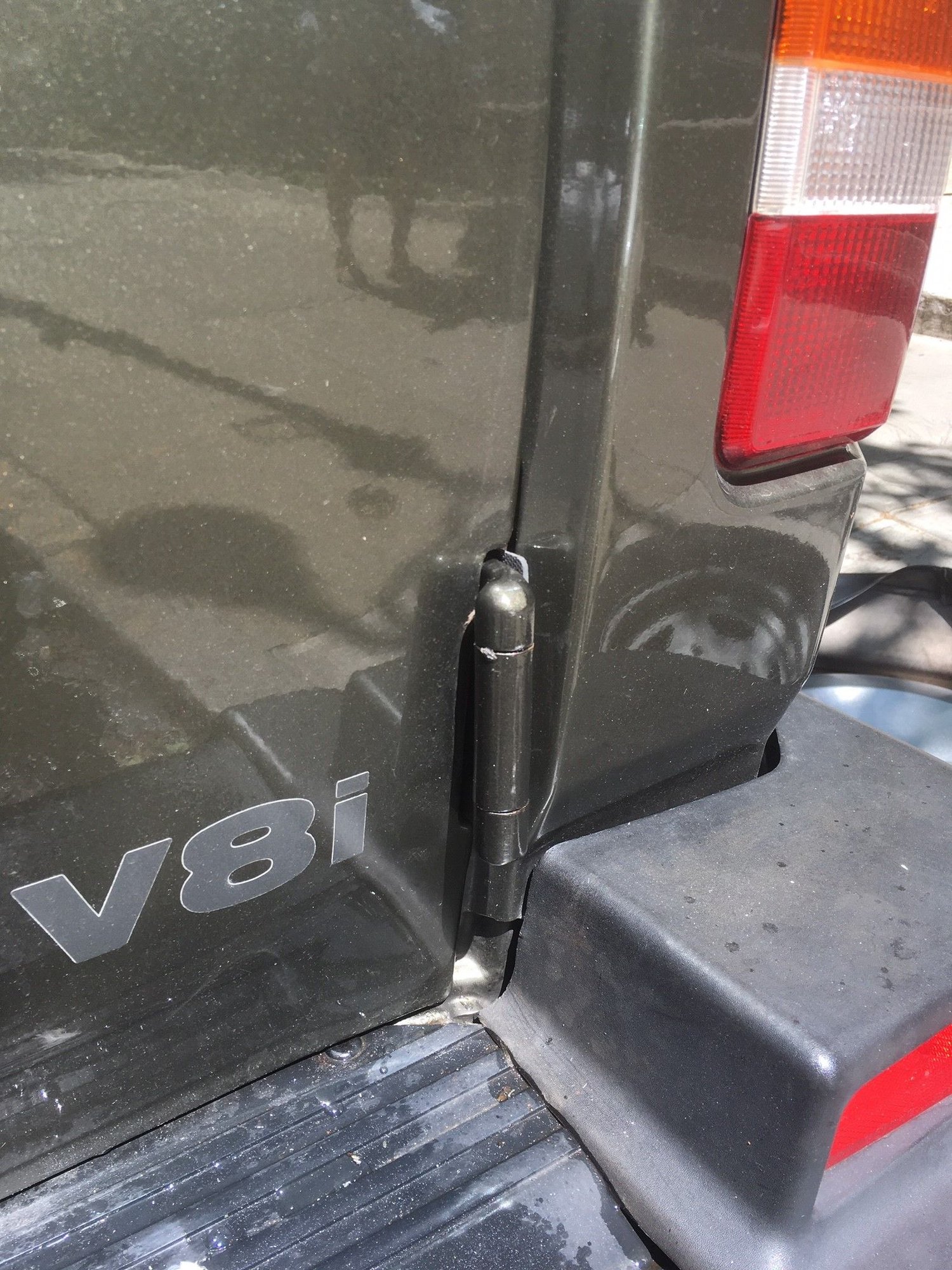

and lower....
I did fashion a gasket out of 1/16" thick rubber to separate the hinge from the frame as I suspect it would corrode otherwise.
