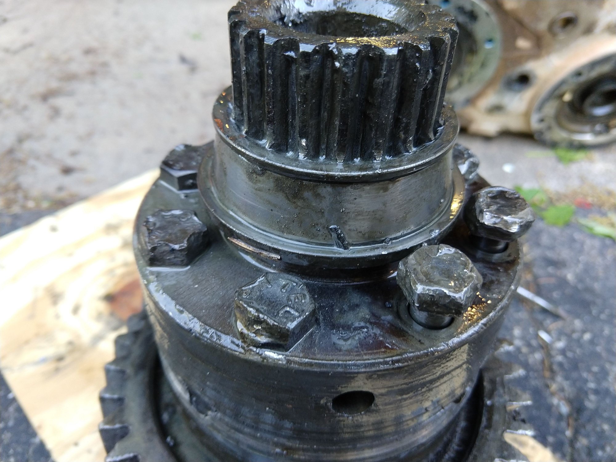

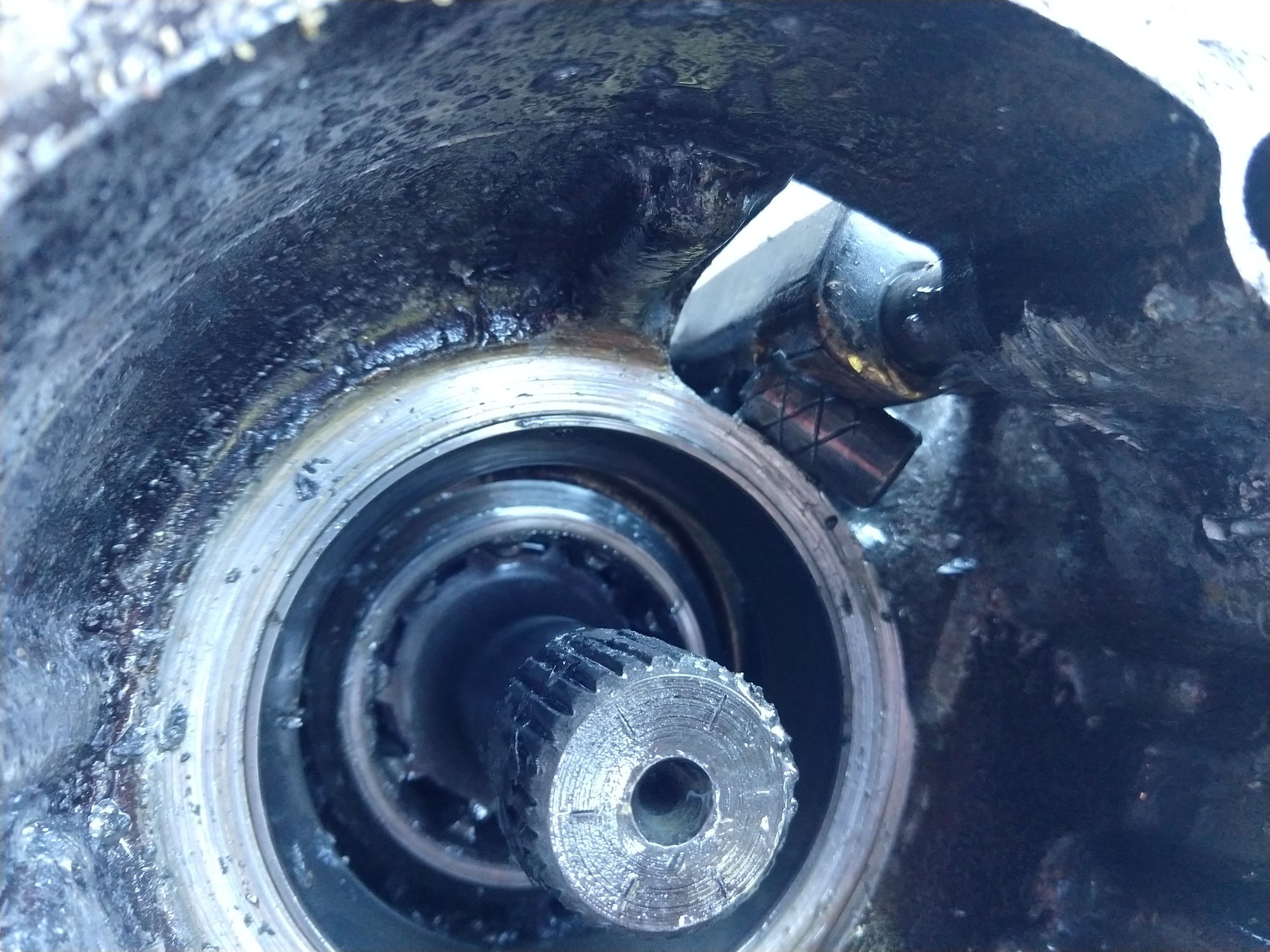

Haven't had a chance to figure out how to open the diff up because the bolt heads are all sorts of mangled.
there's a giant v groove around the center of the carrier caused by the debris too.
CDL shift rail is bent/jammed up by a big chunk of cross pin.
