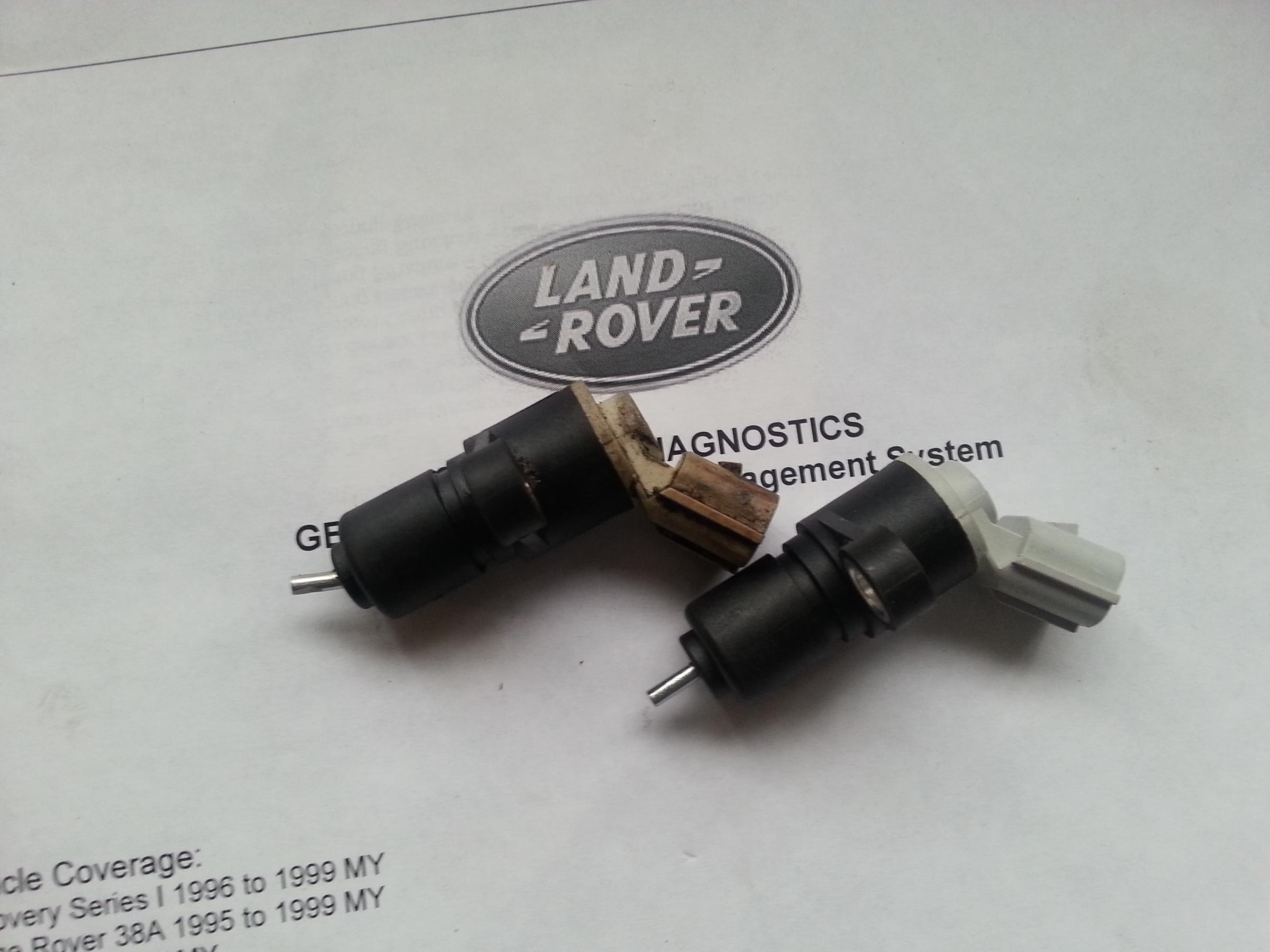

I'm working on a 96 Disco that someone else put 3 engines into. The engine in it now has a bent Crankshaft Position sensor and I am trying to find out if it is missing a spacer or if the reluctor ring is loose. Any help would be greatly appreciated.

Pull the inspection plate on the bottom of bell housing and check for loose plate and bent teeth
