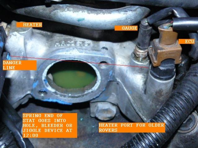

I have noticed similar with my D1 and a scanner, the numbers jump 2-3 degrees on a refresh. I attribute this not to a sudden change in temp, but in the electronics of the ECU that uses analog to digital conversion and pumps those digits to the OBDII port. The UG is just the display. I suspect that the ECU has a lot of things to think about and compute, and sometimes cental processor time is sliced off to more important things for a few moments. Just like your computer can be fast or slow doing the same tasks depending on what is going on in the background processes.
That said, the electrical connector atop the two wire coolant sensor could be cleaned up and the prongs of the sensor degunkified. It is the one on the right.
