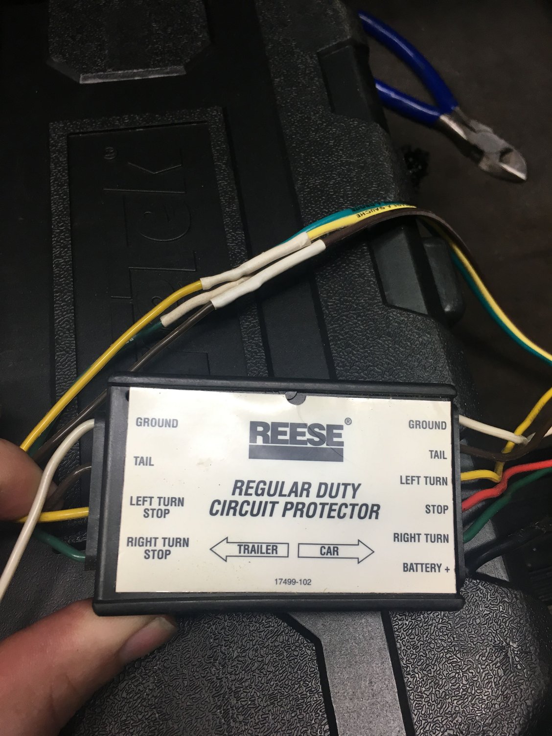

I have read so much about the wiring and how to wire a LR's harness to everything. I bought a converter from Advance and followed directions. I ended up with running lights and nothing else. My D1 have a black plastic 7 pin round plug with 2 separate wires with a factory looking ends on them by passenger side tail light and a clear plastic harness connector with a few more than 7 pins. I am at a loss for what to do, I'm sure this has been gone over many times. Thank you for any direction I can get.

I cut off the factory 7 pin and then just make my connections.
TRUCK to CONVERTER
Black to ground
red/orange and Red/black to Tail. (There are 2 wires for the tail lights)
Green/Red to Left turn
Green/purple to Stop
Green/white to Right turn
Purple/Brown to Battery +

I had everything as you say except the two wires for the tail/marker. So I soldered that on in and nothing. I have sold thicker purple wire left a green and. Row. And a red and yellow left. I don't have anything hooked to "battery". I'm not using trailer brakes just a simple 4 flat

What adapter are you using? I had to connect battery for the unit to work.

Hopkins 311-0041-130
it looks just like yours I think

Hopkins is stating that this converter is for vehicles with led tail lights. That may be some of your problem if your wires are connected the right way.

I have another 98 Discovery I will check it out as well. I am wondering if my truck harness is good now it could be the trailer I'll check it tomorrow with a tester. Thank you for your help.
