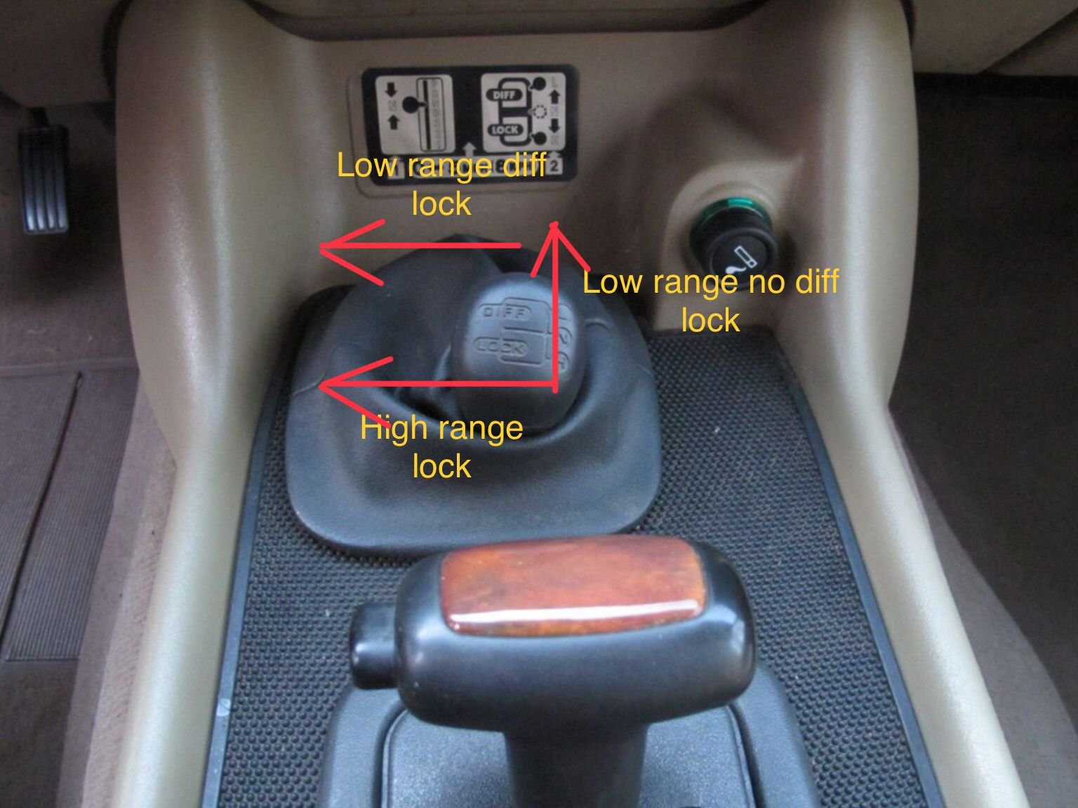

You can slide the CDL **** to the left from its current position at a stand still or at a slow forward roll (0-5mph) with no problems. It will engage and illuminate an amber light in the dash.
If you push the **** forward from the current position, you must be in Neutral. So, gear selector in Neutral, CDL **** push forward,gear selector back to Drive.
Now, the important thing to remember here is NEVER drive it on pavement while in low range diff lock.
Find a field or something and practice a little. Make sure the CDL engages or you will hear a grinding of the gear. No force should be needed, just a firm push and you are gtg.
The most aggressive position is CDL **** forward and then to the left. This is low range diff lock and is only to be used when absolute traction is needed. And never on a paved or flat road.
