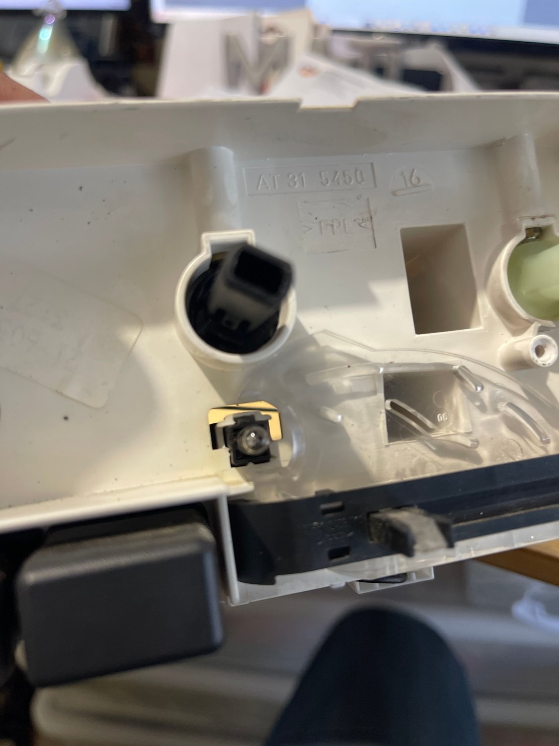

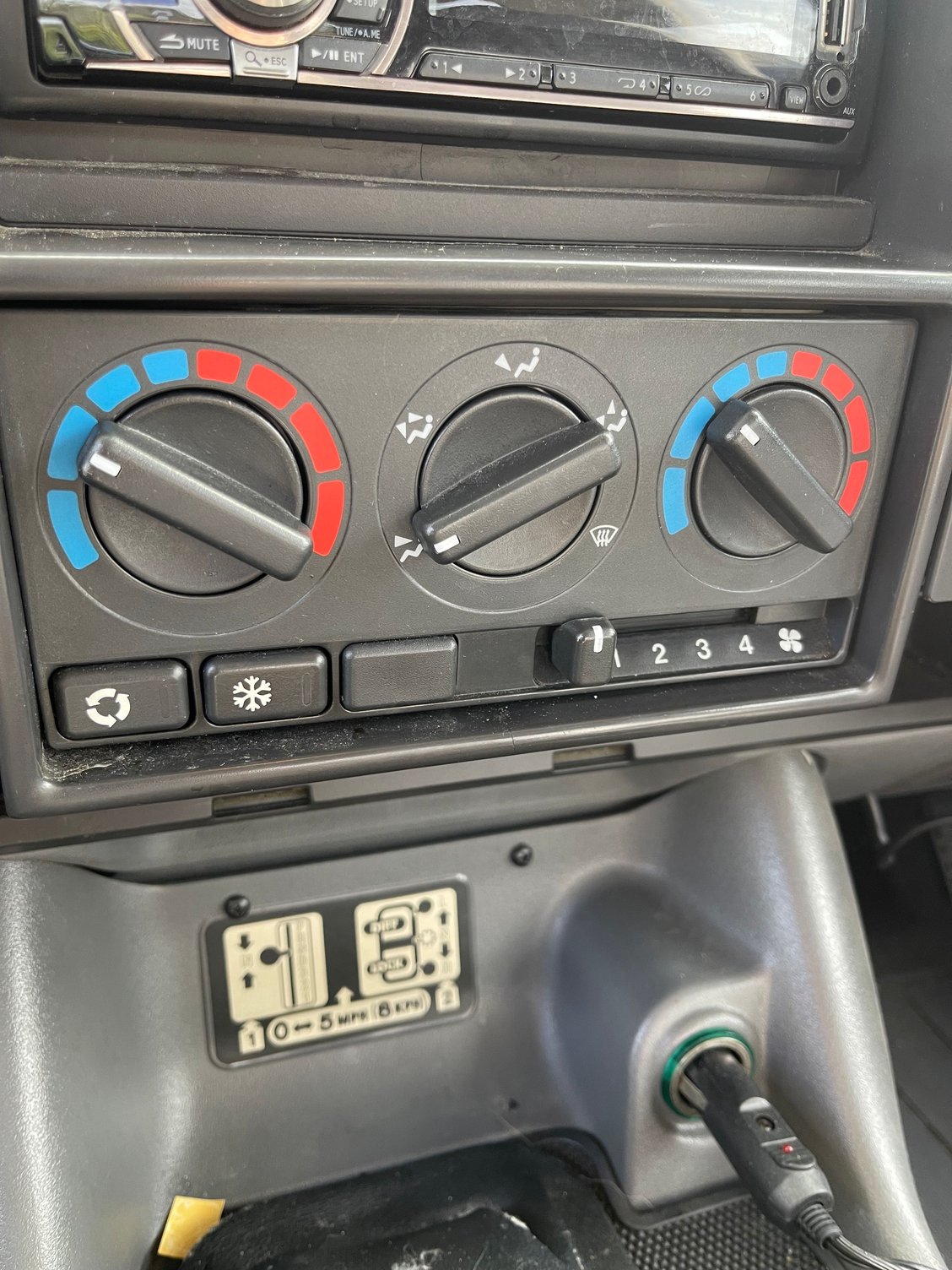

Can someone advise how to replace this bulb that illuminates the climate controls on my disco 1. Th tried pulling will pliers but does not want to come out. Worried I will break something. Is there a trick to it. Can't find any references in manual.
Appreciate any help

if it is original bulb after 30 years they can be tight - hit it with a little electrical contact spray and it should wiggle out - just went through this myself

The two above come out with 1/4 turn CCW. Looks like the little bugger below might be clipped into the gray plastic holder, to illuminate the fan switch numbers.

Thanks, it pulls straight out, needed a little spray lube it was stuck hard.
