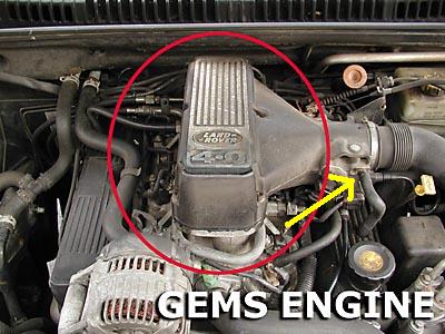

Ok, here's what I remember from when I did it. I also had no adverse effects when doing it.
Pull off the tube indicated by arrow in pic(risregard the red circle).
Attach a length of tubing to that port, a small funnel also helps. Use an assistant to work the accelerator pedal. Slowly pour the SeaFoam into the port, your assistant will need to give it enough gas to keep the truck from dying. When the bottle's empty reattach the black hose to the port and let truck sit for 30 minutes. Start up the truck and drive it like you stole it around somebody else's neighborhood.
