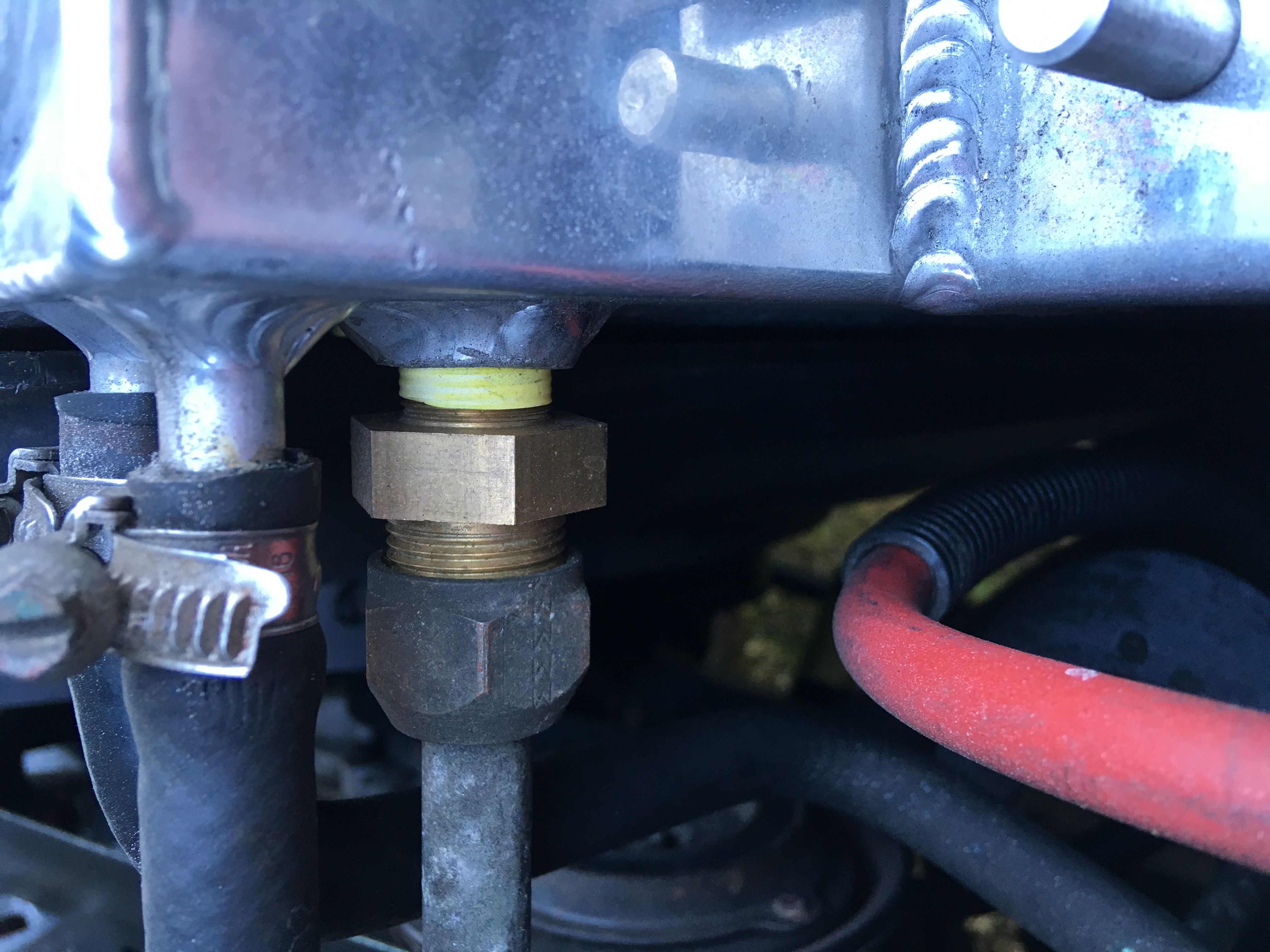

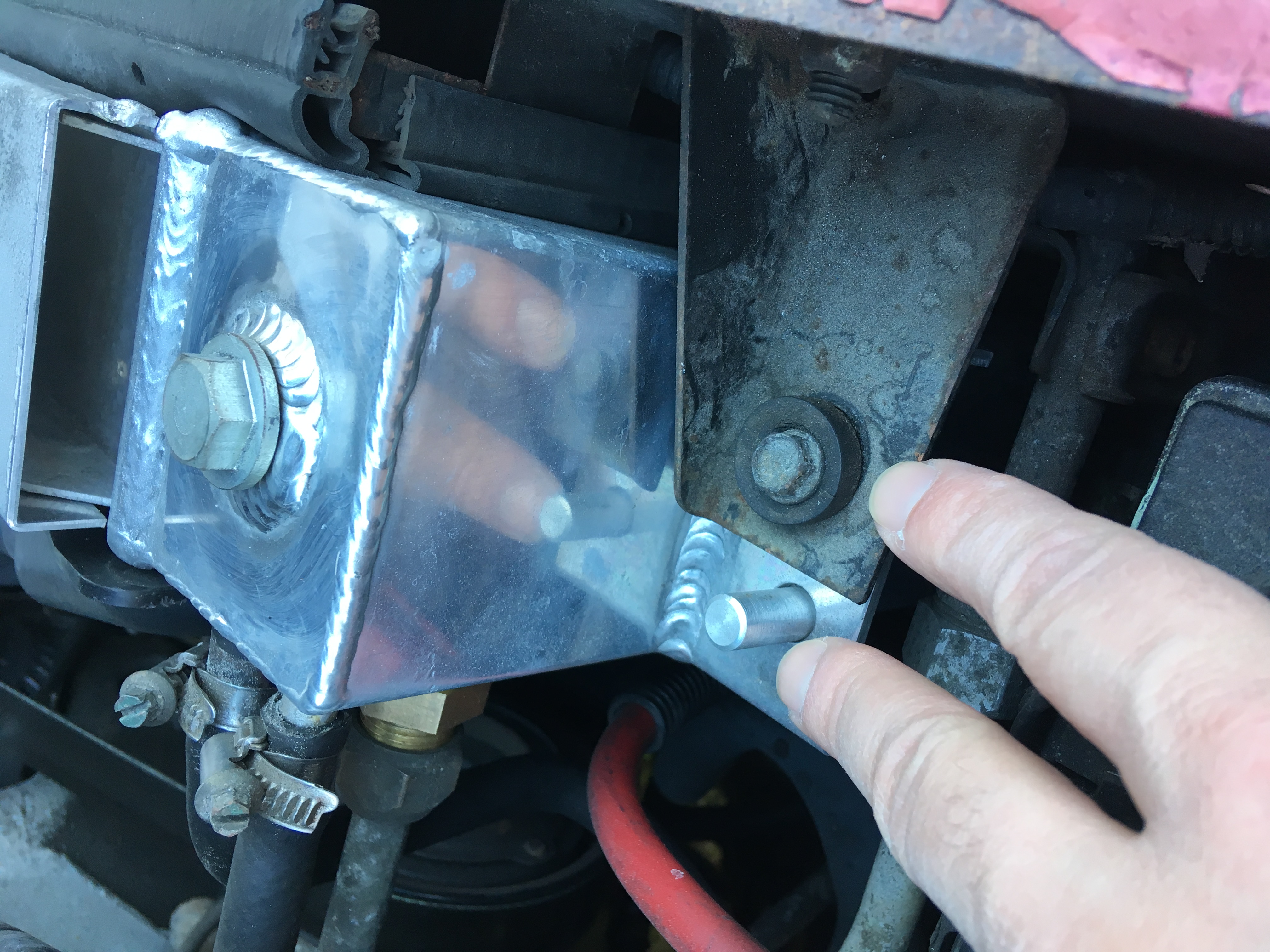

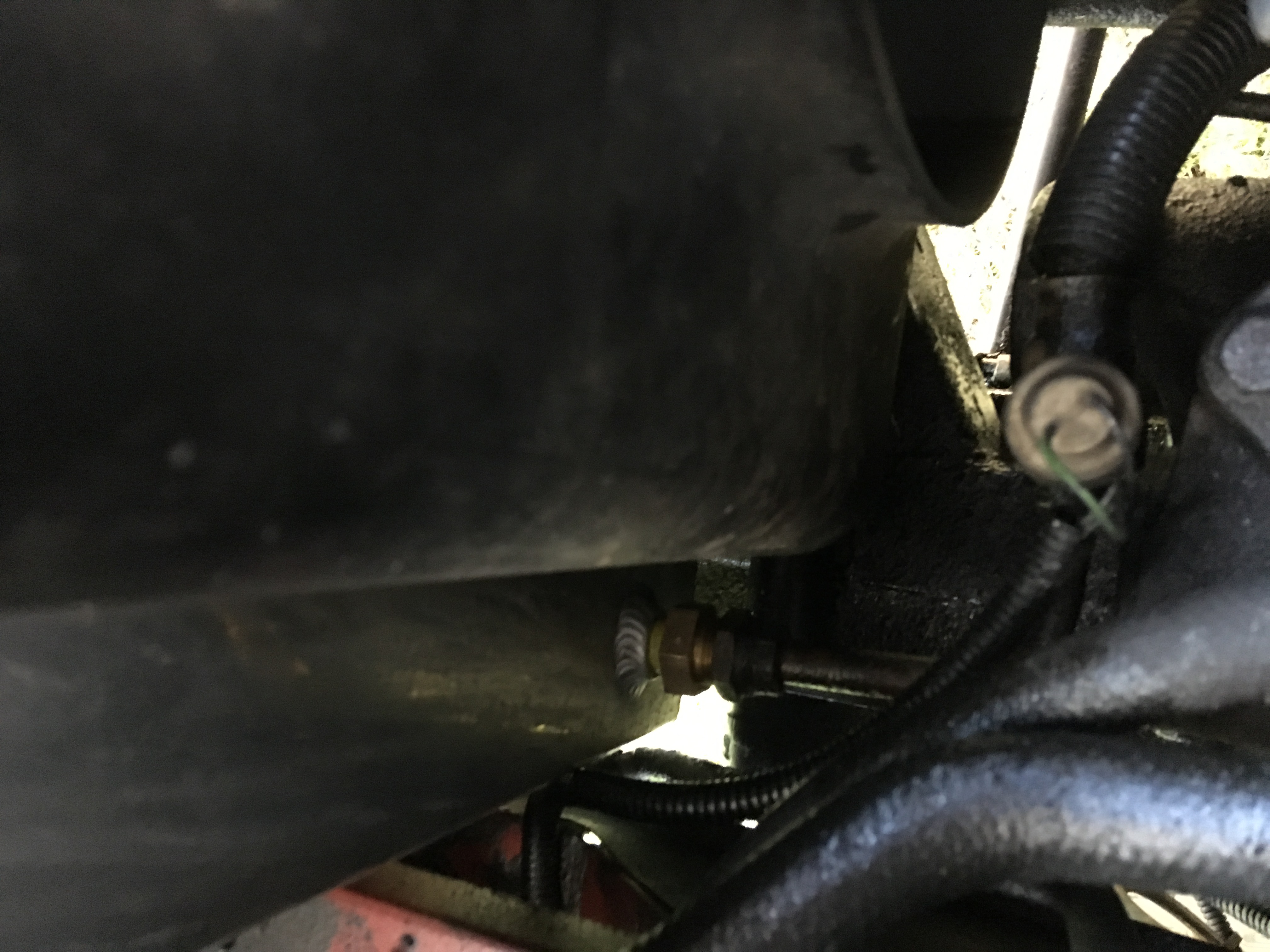

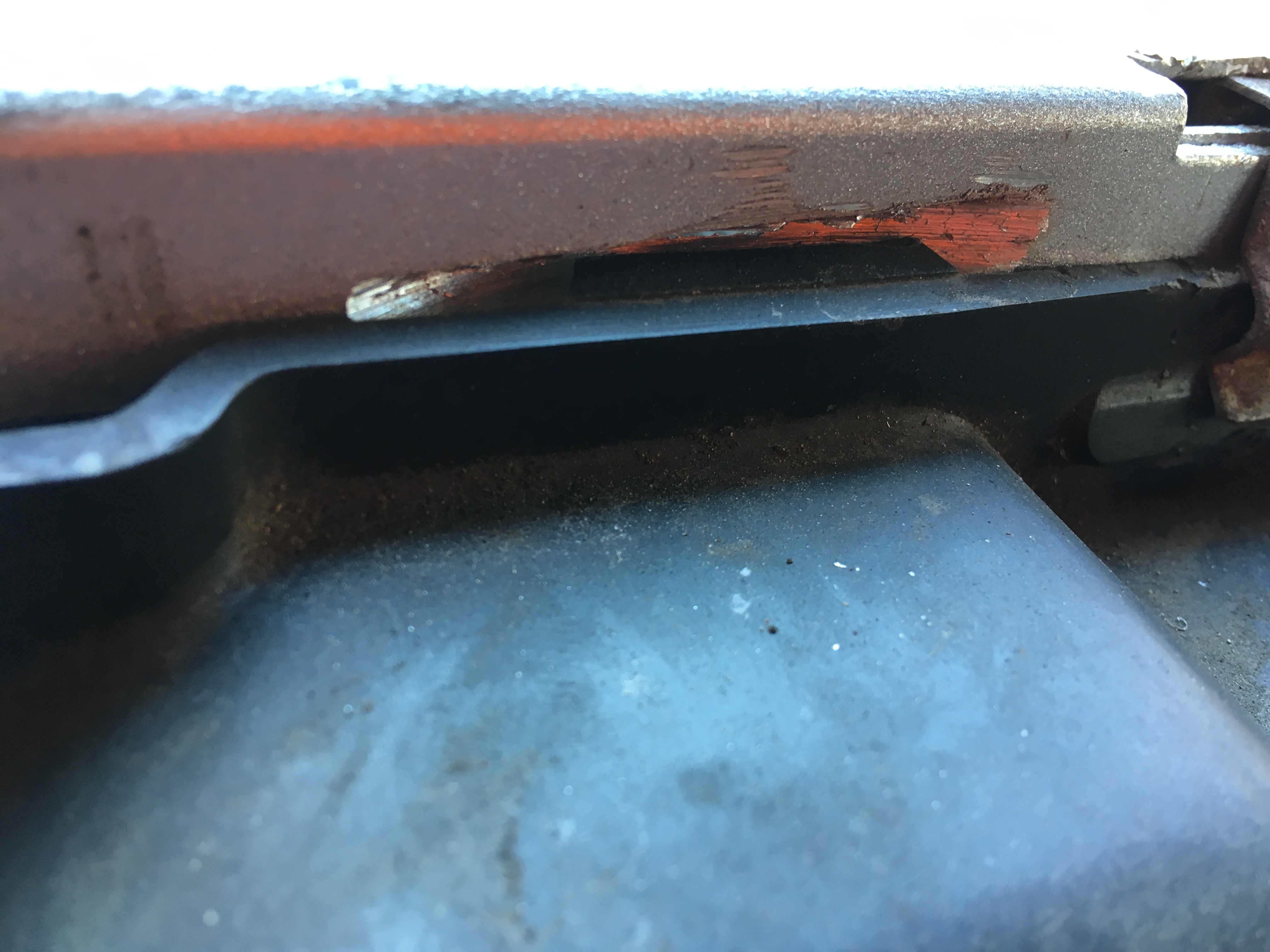

EDIT - THIS ALUMINUM RADIATOR TURNED OUT TO BE CRAP - DONT BUY
the ebay ones for 230 are 3 row - but I believe those and the 4 row I have are all made from the same factory in china somewhere
I believe the manual and auto both use cooler lines so there is no diff
remember the aluminum ones will require some fabrication and patience
attached are some pics of what to expect
Attached Thumbnails Disco I Replacement Radiator-img_1573.jpg   Disco I Replacement Radiator-img_1574.jpg   Disco I Replacement Radiator-img_1575.jpg   Disco I Replacement Radiator-img_1576.jpg   Disco I Replacement Radiator-img_1577.jpg
