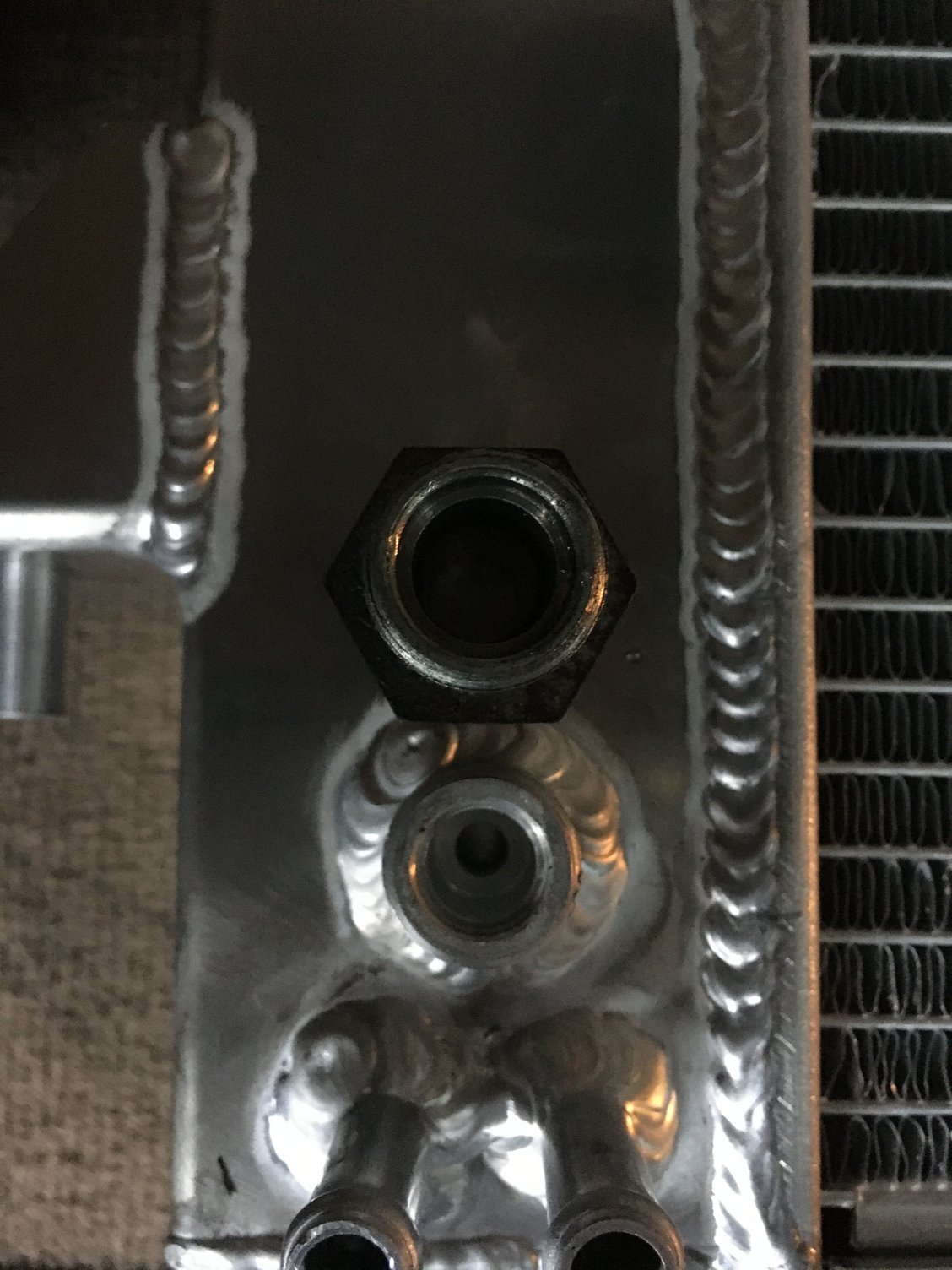

I'm gonna give the Ebay wonder a try looks like the darn cooler lines will work so we'll see!

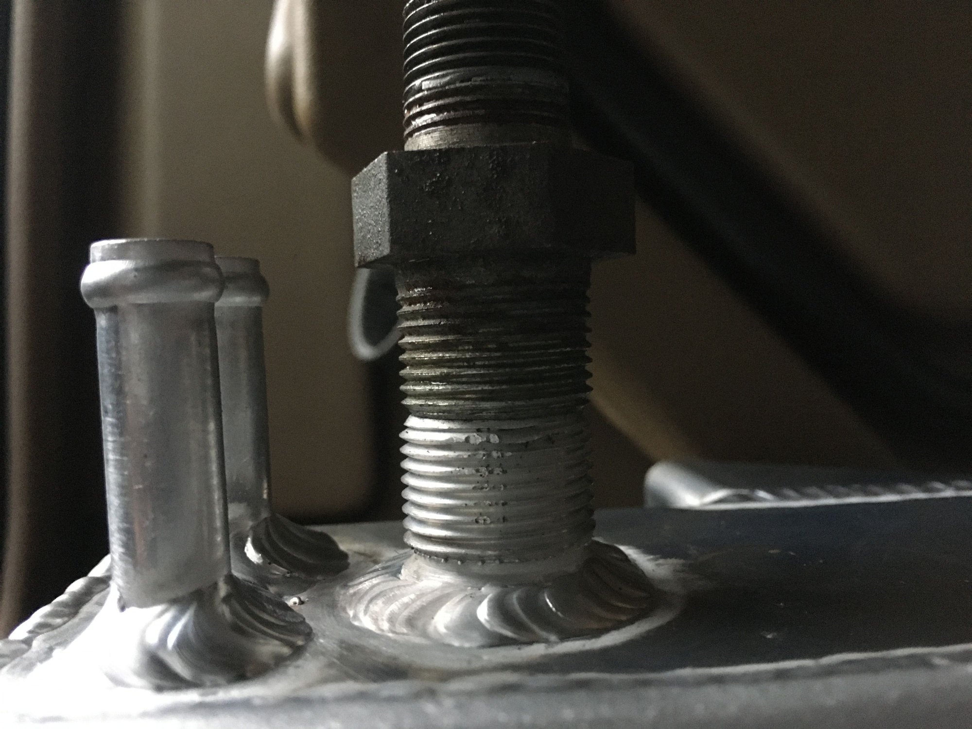

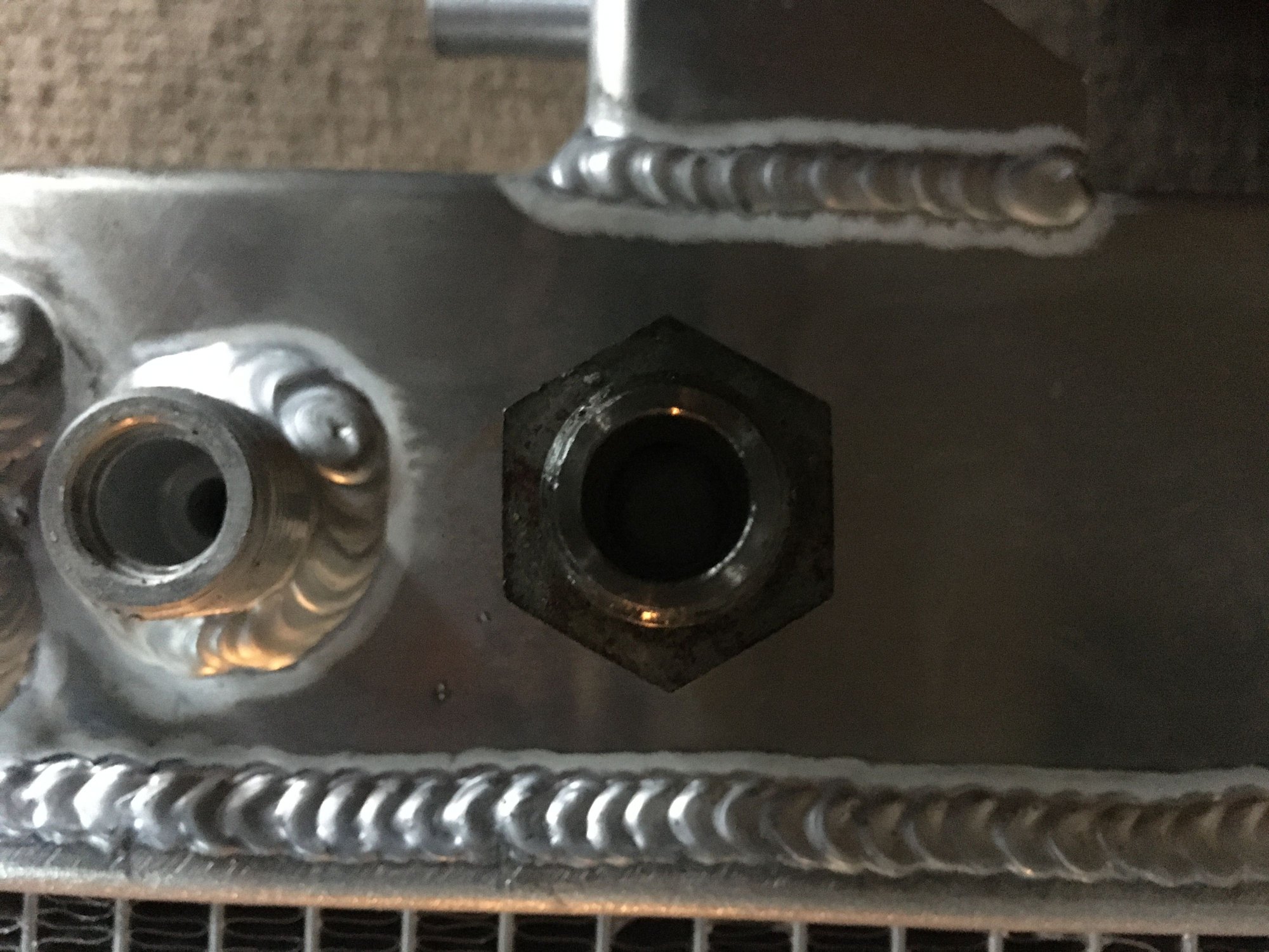

Im sure u can get some brass threaded adapters from the big box or fastenal, you just need to know the sizes, either a female to male to replace that factory fitting or
, got lowes or parts store and get a female female brass threaded coupler, looks like pipe thread , unless it will stop the lower line from fitting

I took the adapter from the radiator & couldn’t find anything locally. Ebay vendor has finally contacted me so working on a return. I’ll just run the plastic tank unit and call it a day. I also ordered new support bushings as they were all rotten/cracked.

best 4x4 - take a look at post #7 thats what the adapter should look like - got it from Atlantic british. But if you can - return it. Yours looks exactly like mine aluminum one did and that didnt last but 6 months before I noticed it was leaking.

I have those adapters from my OEM radiator. The aluminum one = can’t thread those into the radiator as their nipples are welded on. They do not unthread from the radiator so those adapters are 100% useless. I was shown a set of female/male adapters from an older RRC, but my buddy said good luck finding them today.
