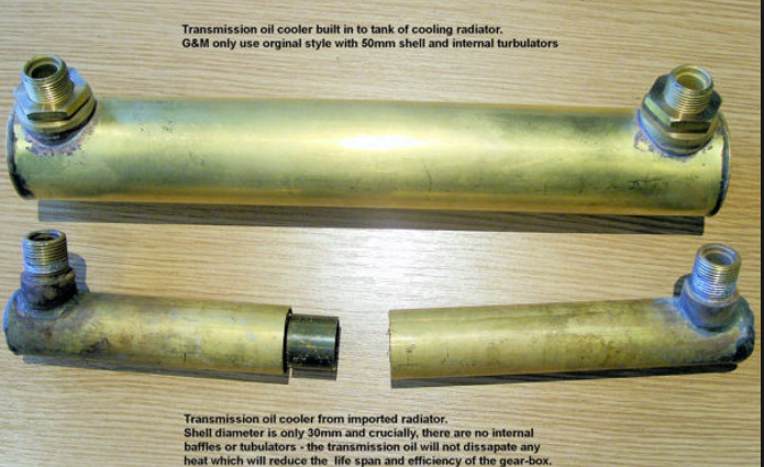

why do I keep hearing people say to stay away from the plastic tank version?
The cheap-o plastic tank radiators have the same problem that the cheap-o all aluminum rads have.... undersized internal oil coolers.
The increased heat causes the bond/weld between the tanks and core to get cooked and then separate = LEAK.
IMHO if you are going to go with a plastic tank radiator your best bet for quality is a NISSENS 64029

I thought you only had the Aluminum Rad, I didn't know you still had the OE Rad...a RE-CORE is always my FIRST CHOICE!
The tanks are way thicker and the oil coolers are large and brass. It makes all the difference.
Expect the cost to be about $250 - $350 and if your rad guy is good it's 100% worth it.

I'll give you one headsup re: a re-cored rad and it was a lesson I learned from a friend who had to the hard way. BEFORE you install the Rad flush the core with water and blow the oil coolers out with air. Then fill the oil coolers with ATF and Engine oil (they don't hold much) and let it drain out. This will add all of 20 minutes extra to the install.
I know this is overkill and I've never had a problem, but the issue my friend had was the Rad Shop sandblasted the tanks and some sand got into the coolers. More in the AT Cooler and it was not good. So it's worth taking the few minutes to be 100% you are free of problems.
