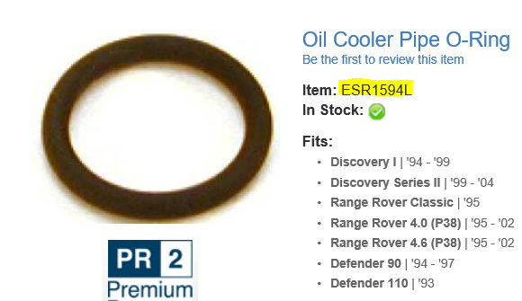

If you want to use a chemical to clean the coolers I use CRC 091314 Brake Cleaner. That is the Chlorinated type with NO Acetone.
Paint Thinner/Mineral Spirits will work too.
You don't need much (3 -4 trigger pulls) then let the rad sit flat for a few minutes. Now flush the coolers TWICE with clean ATF and Engine Oil. It will only take about 1/2 QT total and all the snot is gone. If you are unsure the cleaner is gone just look for bubbles in the fluids. When the brake cleaner is gone there will be no bubbles in the fluids. It's really that simple.
RE: 3 or 4 row cores I've done both and didn't see any real advantage (on or off road).
If the Rad Shop will do a 4 row for a little more $ and it makes you feel better then do it. If not in the budget don't sweat it.
And remember to replace the (4) oil cooler o rings ( ESR1594L ). They are the same for the ATF and E Oil.

oh yeah been drinking - got the o rings already - ordered extra before
