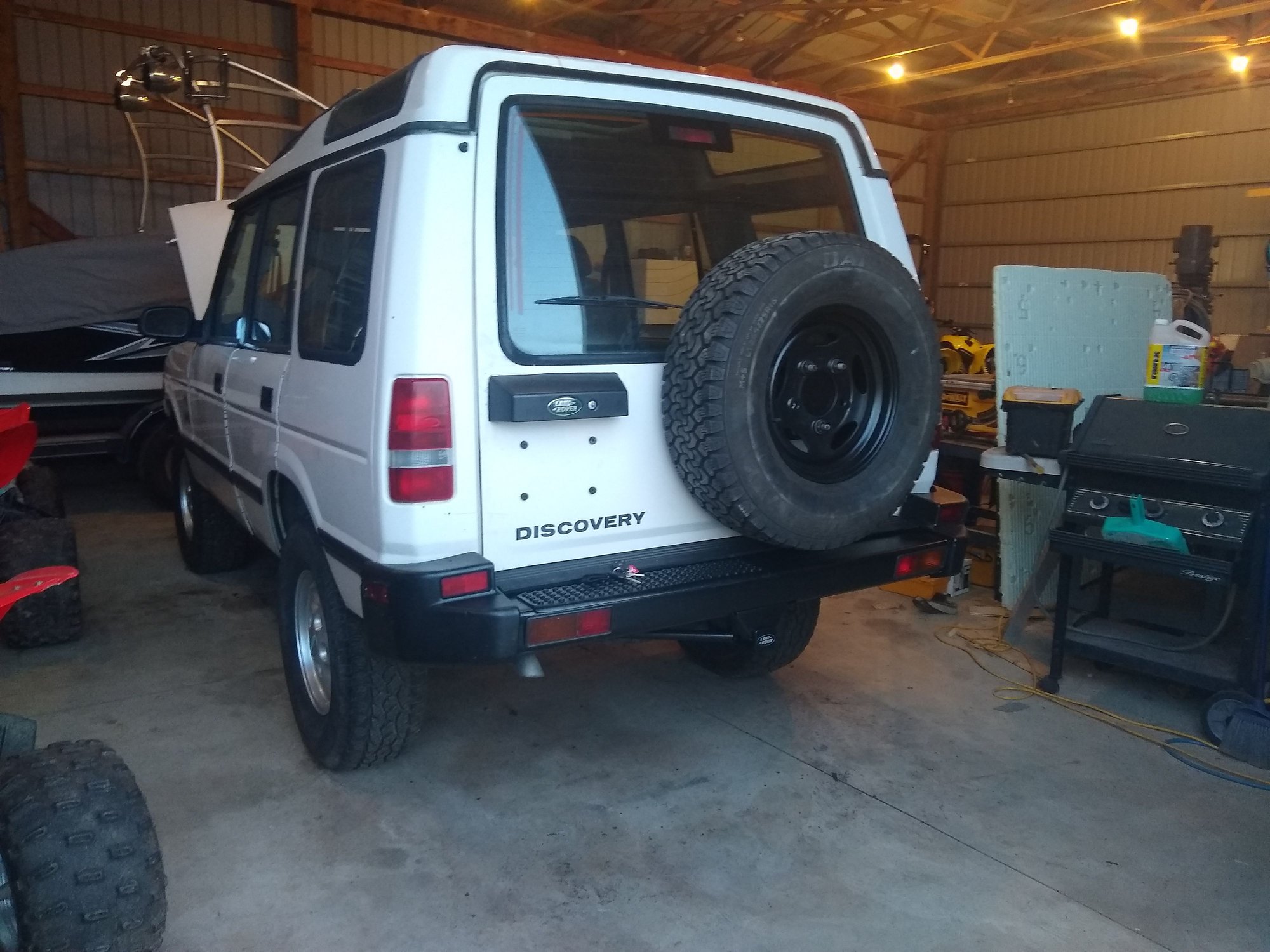

Old Jun 7, 2019 | 05:08 PM
  #37
WeekendWarriors87's Avatar
Joined: Aug 2018
Posts: 171
Likes: 16
From: Canada
UPDATE 2019 JUNE
So lots has happened in the last while, and she is finally on the road. Still lots to do, but at least the majority of the hard work is done.
Since the last update, I replaced the steering with HD bars and new tie rod ends. Fixed the headliner, which I painted, then reinstalled it. Fixed a bunch of other things like the tailgate door stop that broke. Did a self alignment, did a bunch of paint work on the rear bumper, spare wheel, hitch, etc. Removed lower front bumper. Chopped the mud flap mounting brackets, and did a few other clean up things.
Still to go in the near future: More paint work, O2 sensor on pass side, AC recharge, transmission seal, some interior trim work.
Far future: rust repair in floor, some seat modifications.
All the new parts installed, along with insurance and safety done. Road ready!
rear bumper repainted including plastic end caps, all hardware replaced with stainless steel, including the screws for the reflectors. Painted the tailgate handle and the spare wheel and lugnut, as well as the hitch underneath.
