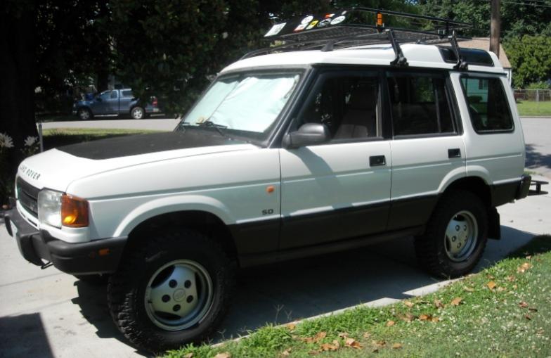

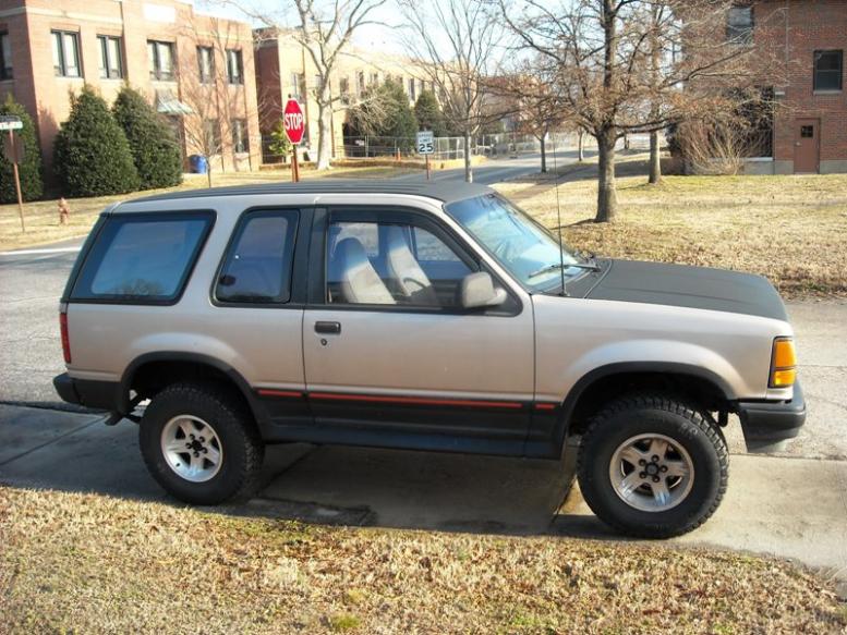

I have a '93 Explorer Sport, 2wd, V6 with a 5-speed. I lifted it 2" with coil spring spacers in the front, and longer spring shackles in the back. Installed longer front shocks and rear air shocks, and put Jeep alloy wheels with 31x10.50-15 AT tires on it.
Also put a 2" lift on my '99 Disco I, with OME springs and longer shocks. Let me tell you, the ride difference between the Explorer and DI is like night and day. The Explorer is bouncy, squeaky, uncomfortable for long trips, etc. The DI, on the other hand, feels like a rock, handles great, and I feel like I could drive it all day long without being any worse for wear.
I guess that's what happens when you have a better platform to start with, and lift it the proper way!
