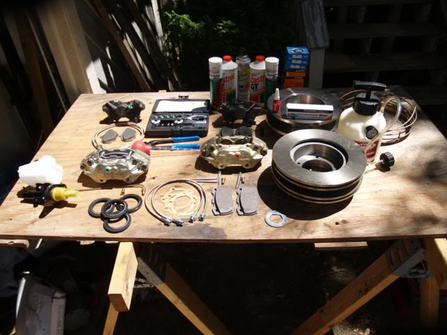

Thanks. They are actually from photos taken when I was converting my D1 to D90 fronts. At the same time I installed all new calipers, new master cylinder and new stainless braided flex lines.
This is the first photo in the series.
