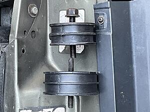

I ordered both the Jag mounts and the ANR2805. The Jags are a bit larger and have a different thread. They look to be m10 x 1.0.
https://landroverforums.com/forum/at...1&d=1702158473
So I'll order new flange nuts.
I sized up some things in the engine bay and I could barely get the bottle jack between the frame rail and a/c compressor. Do you move the a/c compressor to the side? I suppose it is a bad idea to jack directly on the compressor...or is that kosher?
