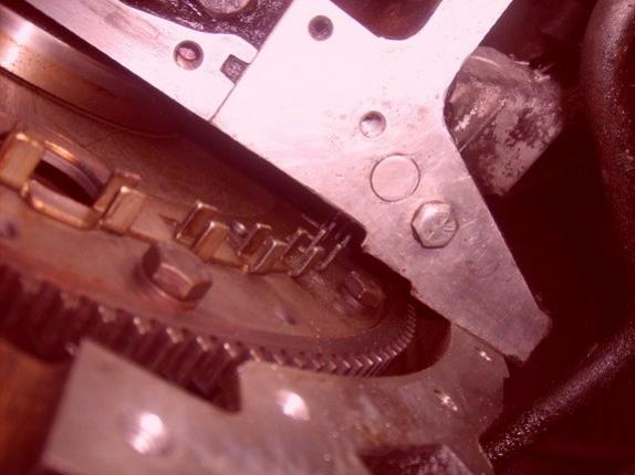

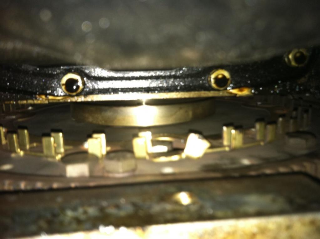

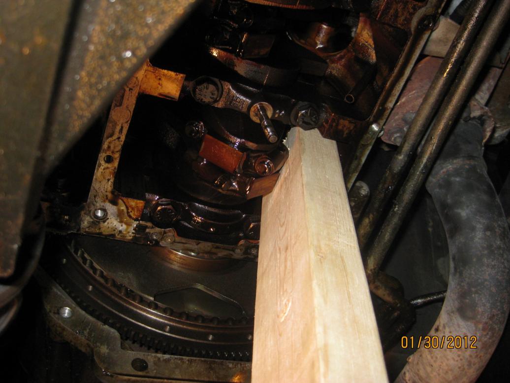

Ummmm.... be careful in the inspection cover lest you disturb any of the reluctor tabs. Break or bend one and the crank shaft position sensor won't like it, ....
Keep up with all tools, don't leave any for the next guy.
Wood block makes getting crank pulley off a little easier.
