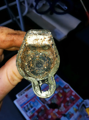

Well, I am happy to report good news!
I pulled apart VSS, that was the easy part, but getting to it was damn tricky, and left me covered in debris with a mouth or two full of dirt and grime!
VSS was filled with the plastic shavings as described in the VSS rebuild PDF, and extremely filthy on the outside!
The metal bit was very loose and wobbled from side to side quite a bit before taking it apart... which worried me.
Once apart I noticed that the plastic/teflon washers were not the diameter as mentioned (guess they had worn down). I cleaned everything meticulously with a toothbrush and seafoam. Applied some lithium grease to the thrust washer, and reassembled...
Vehicle shifts nice and smooth now (manual transmission), and doesn't jump or buck like it used to in any gear or in reverse
I also cleaned the PCV valve and the pasta-like breather, but all lines and parts were fairly clean.
Speedo works 99% and only lags slightly on acceleration from a dead stop, but properly speeds up and registers.
Granted this is not a permanent solution, but for now it will keep me going
Thank you for your help and time, it really means a lot

I followed the article listed on Discoweb for removing the VSS, and the thread started by grptech on "repairing the VSS".
Here are some pics of the VSS I pulled out before cleaning it.
That is the inside, look at all the debris in there
Below are the pieces from inside before I cleaned them, all that metal looking dust/dirt is plastic debris.
