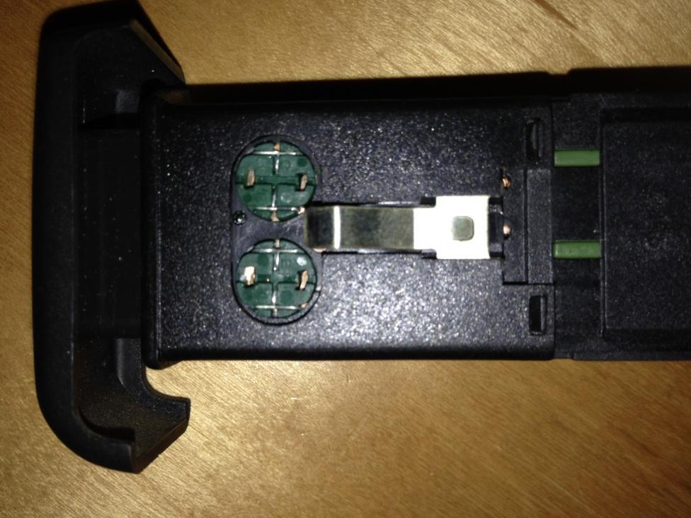

So, My fog lights didn't work. I figured it was a relay or something. I have power coming to the switch, but none leaving the switch.
Today I changed out with a known working switch, and Voila! My Fogs work.
So, I have like 5 switches that do not work. I have tried to dis-mantle them and repair, but I just break them. Does anyone know the deal with why they stop working and how to repair them?
Thanks

There is a copper spring-connector inside it looks like the back of a spoon one big and one little connected that gets weak i bent mine to be a tighter fit. The latch is also not working so i wedge a toothpick to hold the switch on.
I couldnt find a new switch.

To bend them, do you have to open the switch up? Are you taking about the outer copper thing?(photo attached)
Thanks,
Abran

Yes,The back part comes off there are 4 tabs that have to be lifted with a flat tool.
