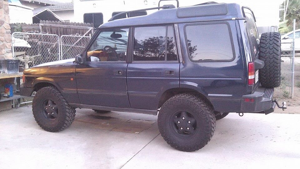

Scoop pic. Also newly painted wheels. Duplicolor truck bed liner.
