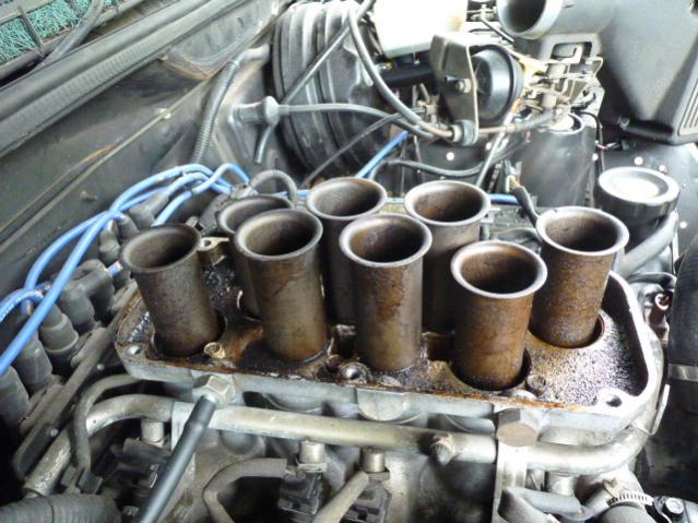

Removed intake plenum with the forest of tubes.

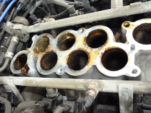

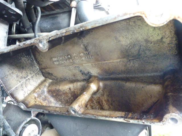

Problems found:
Missing a few washers on the 6mm hex bolts that hold down throttle body. Maybe I'm not the first in here...
Missing the gasket between the bottom part of the plenum and the intake manifold. Now I'm sure someone else has been here. Plenty of gunk on the intake, bolts that hold the bottom section of plenum to intake come out with fresh oil.
Noticed throttle body heater is corroded, so it will have to go as well.
And love the swollen end on the fuel pressure regulator hose. I should have used better hose rather than what was laying around.

There isn't supposed to be a gasket between intake manifold and ram housing... Nix that off the "Problems found" list. Use a non-hardening sealant thinly applied when you re-install. I highly recommend not using silicone. These are milled to mate surfaces. This is the location where risers/spacers are used to change runner length when transplanted into British roller-skates. Of course there is much more modification tuning that goes into the process but you get the general idea....
By the way you don't need to take it down this far to remove the entire manifold/ram housing/plenum assembly. When time is short you remove the entire unit by removing cables, hoses, coil pack and then undo the intakes bolts. One total unit all at once. Not very heavy at all. I do it all the time of course.....

Then where does this go? Many of the web sites list this gasket as extra....

thought that was for the disco2 with plastic plenum

And yes, I plan for this to be fun for all of us, you can enjoy a few laughs at my expense. Actually, I'm glad I took it apart because obviously I have not used enough SeaFoam, and whatever sealant they used has long since cracked and allowed un-filtered air in, etc.

yeah I found that the sealant they used is total garbage, there was dirt and pine needles in the sludge in my oil pan so I would say crap was getting in

I'm not laughing. I wouldn't mess around with your money but by all means try installing that gasket......
Do the trumpets or ram housing bolts follow the same pattern as that particular gasket Buzz? Tom's right, it's for the DII's.

You are right, I just noticed it on the parts web sites listings for 97, but I went back to the RAVE and there is not one shown in the exploded diagram. Thanks for the advice on the sealant.
