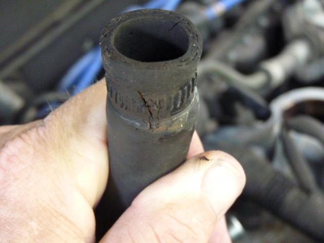

Session 2
Good idea on the Permatex.
Spent time today removing hoses and plugs, found that most of my hoses looked OK from visible side but all have morphed into the MayPop brand (may pop any minute). PO must have put plenty of stop leak in it, the heater hose fitting has quite a bit. Got a few intake bolts out before stopping, they were more than finger tight, which is good. I may have to break down and buy a set of crows feet sockets.
This is gonna take a while at 60-90 minutes a day. Maybe I can get a slow mo camera. But, the pix of old stuff is representative of what others may find when opening their beastie up for minor repairs. Even some of the electric plugs felt brittle / crumbly.
