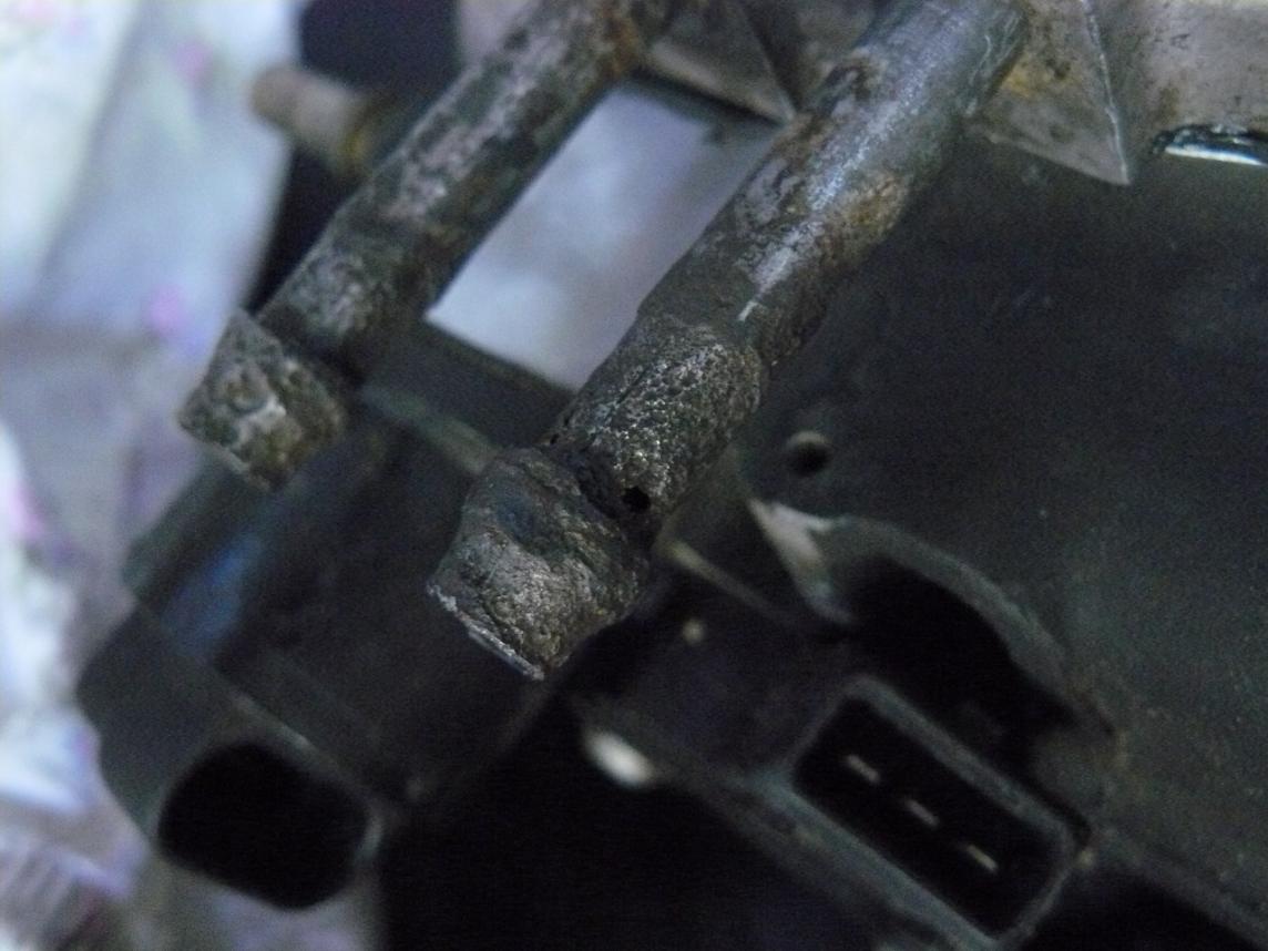

Bought wrong drill for helicoil repair. Worked on throttle body heater gasket, and found small coolant pipes had a couple of pin hole leaks. More parts to order.
