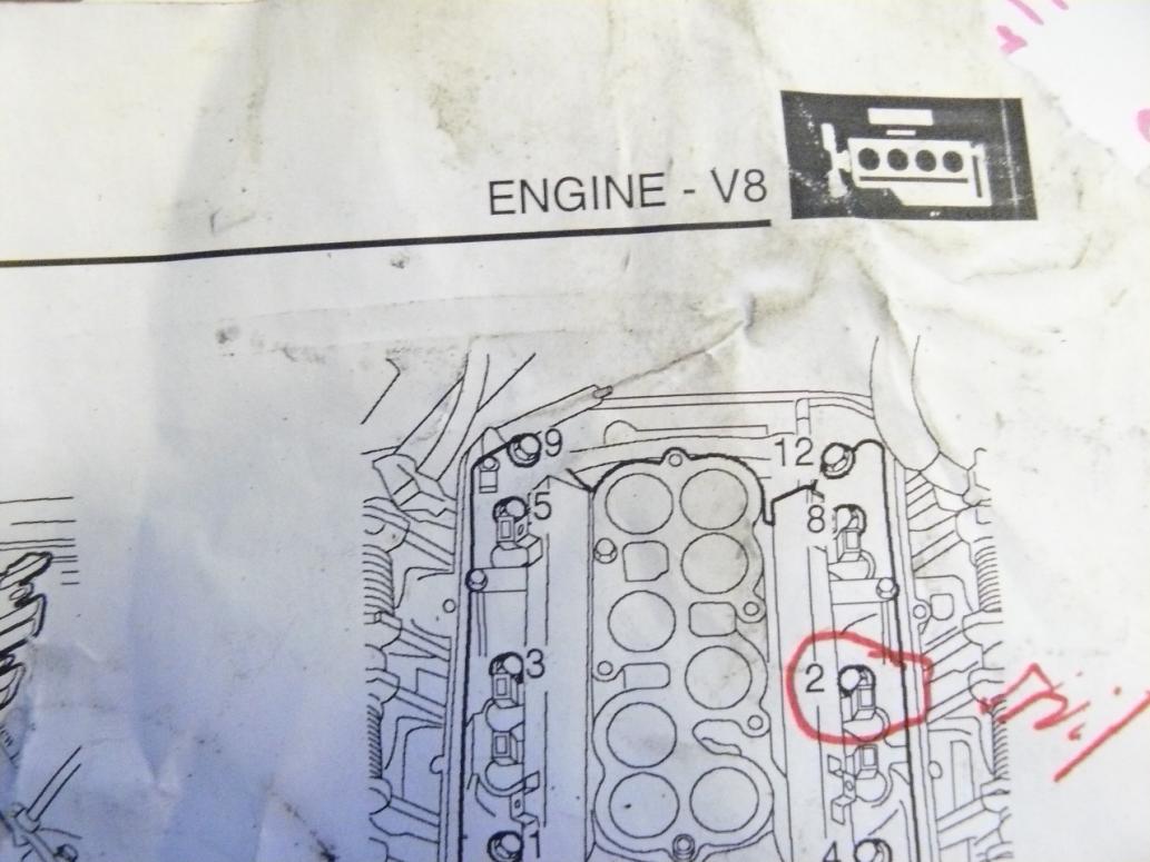

I agree I done bad, but where else in the manual have I missed? And are not the non-SAI heads on a D2 essentially equal to a D1? Seems like there would be a more detailed drawing in the D1 or overhaul manual for bolt sequence for intake. Maybe I didn't see that page?
Does this mean owners trying to follow the book on a D2 may be in line for the same issue?
Pix of page I printed out, but I can't find the exact one again, not sure where it came from. Says Overhaul in bottom corner.
I thought the puckered up valley pan gasket was keeping things from tightening up as it collapsed. Wrong, so wrong.
