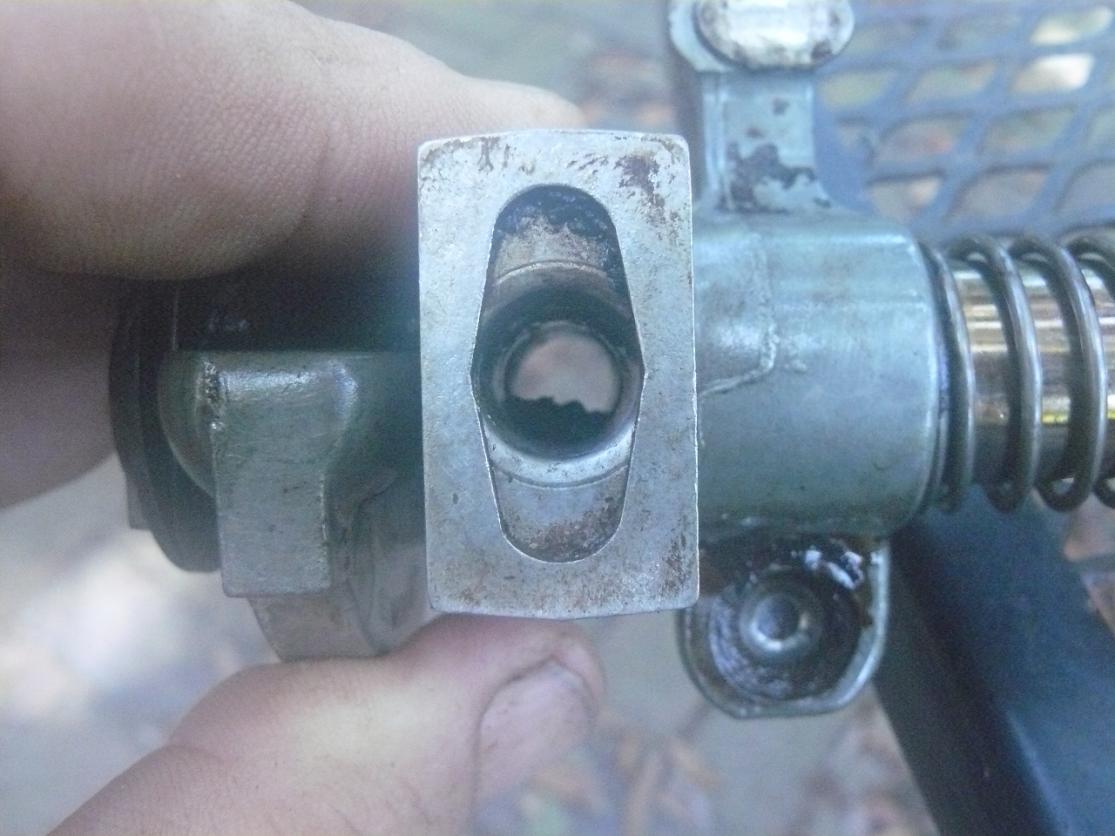

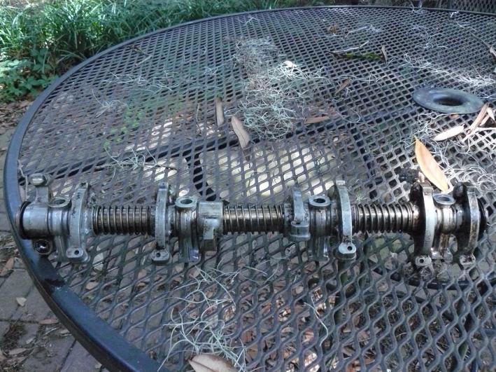

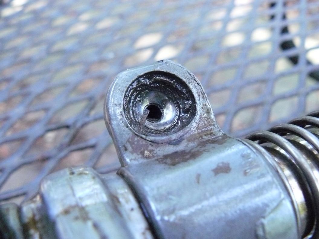

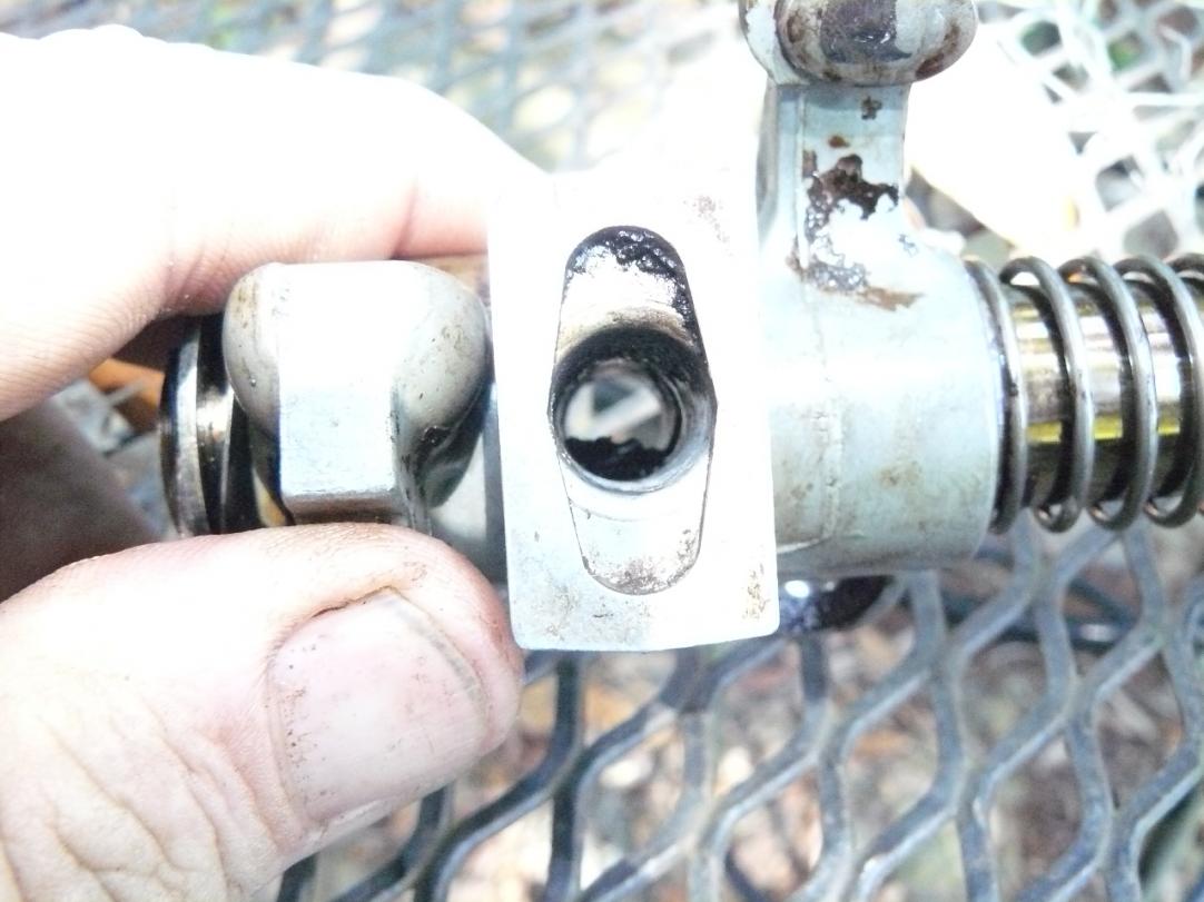

Session 9
Got right side exhaust off, mirror and a small chisle do wonders at finding the fold up lock tab.
On this side, the head bolts were torqued, and I got out my cheater pipe. So previous head work skipped at least one set of 90 degree torque steps on the left side head.
Got to the back two bolts on the head and discovered that any short 1/2 inch ratchet extension I ever owned has gone to live with Elvis. Parts store on the way to work. Hope to get head off and both dropped off tomorrow.
Right side rocker is cleaning up. Note buildup inside one of the towers. IMHO if you have valve covers open, worth taking these off with four bolts so you can clean this out and the companion hole in the head.
