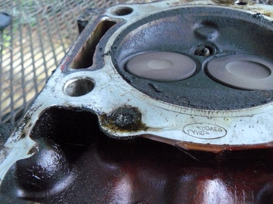

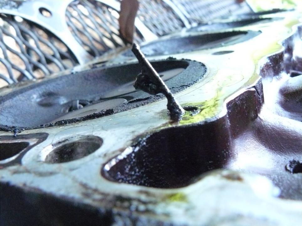

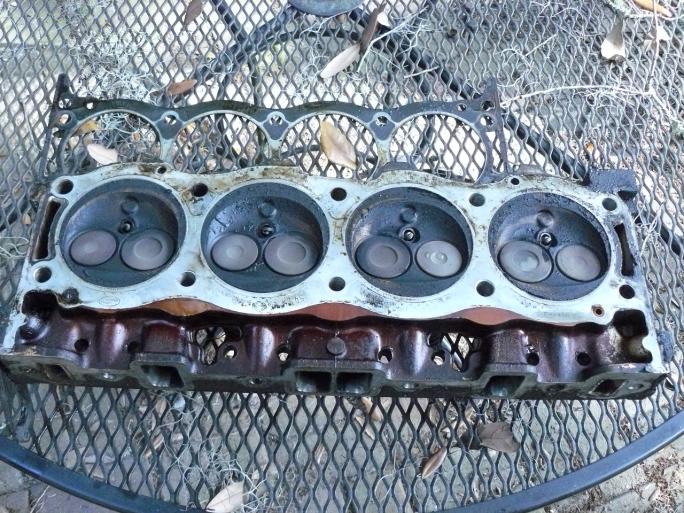

3 inch long 1/2 inch extension plus real cheater bar use got the two back ones out, then head was still held in place by a 10mm bolt that secures the two plastic vent lines from diff and TC.

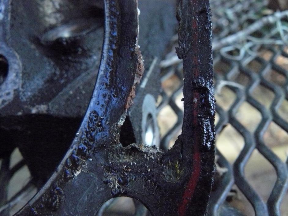

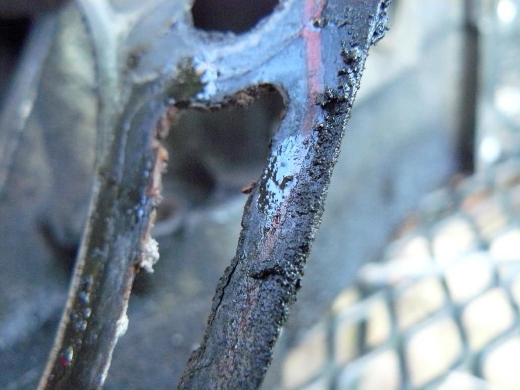

Found some oil gunk build up, then realized that oil is supplied thru the front of the head, the rear port has no path into the block. So there is no left or right side head. The coolant channel at the end sure doesn't have much "meat" between it and the outside word, and looks almost crusty-rusty.
Gasket seemed in place, so my problems were basically an HG job that skipped the second 90 degree torque down, on just one head.
Rocker assemblies enjoying a soak in Berrymans parts cleaner, which won't be enough. Heads to shop in the morning.

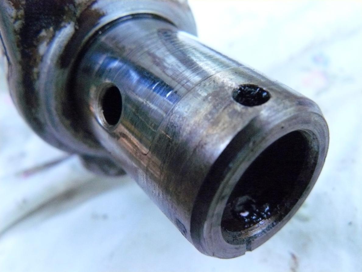

Session 11
Dropped of heads for skim and valve job. Owner said no problem with heat track where gasket failed, skim will remove it.

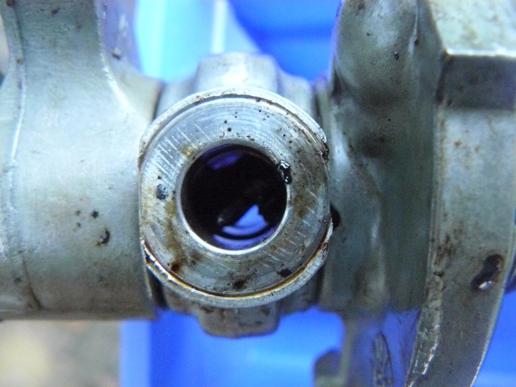

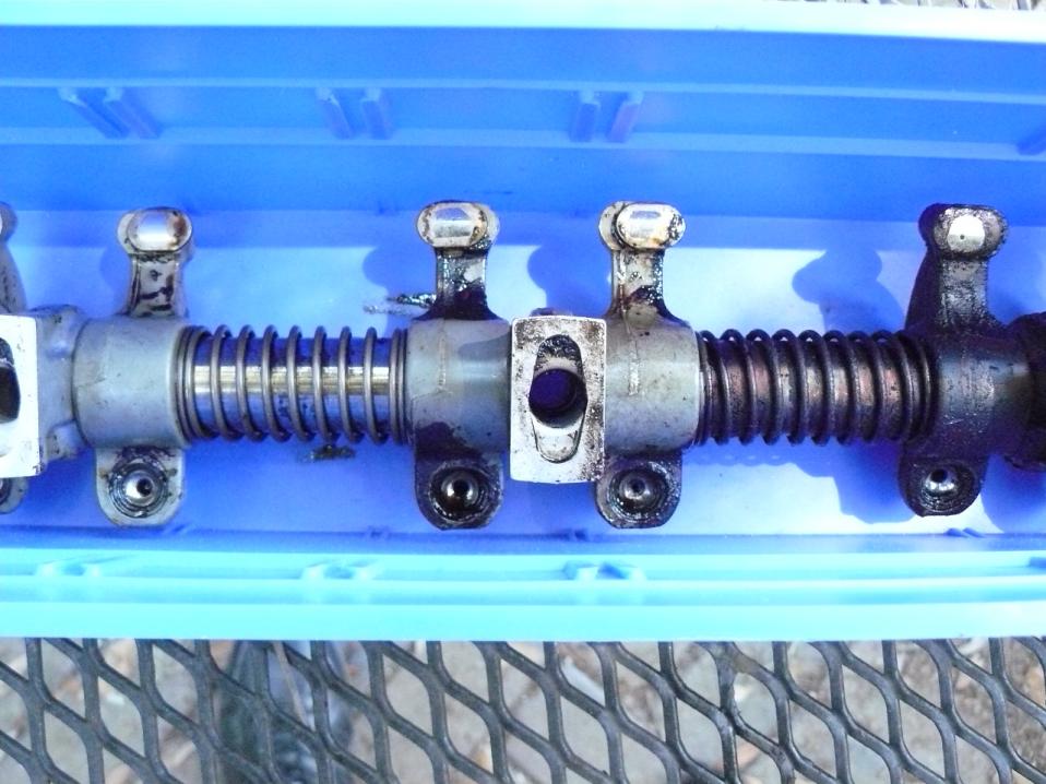

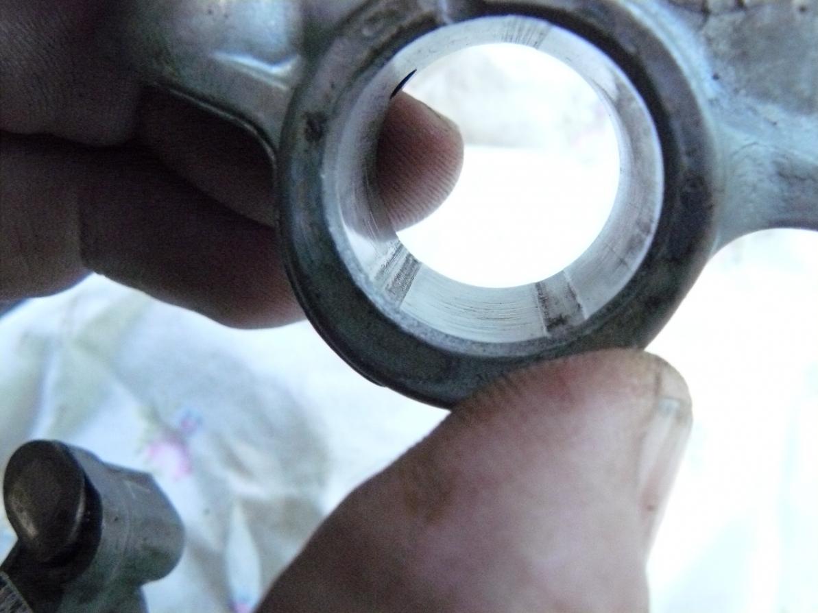

Worked on valve train. Support towers don't come off. RAVE says they should. Assume that a groove has been worn in the center pipe. Crud keeps moving around in center pipe. Note half and half from a 30 minute dip in Berrymans parts cleaner.

buzz the towers will come off you need to tap with lead hammer / brass drift, mine were a pita to get apart there was so much crud, clean the tube as you get them off makes the others come off easier, oil it all real good for reassembly you will need to tap the towers back on they are a good tight fit, be sure the oilers in the main tube face toward inside of engine when you reassemble ( I am sure you know that ) since I oiled the parts so much it took 2 people to reassemble once apart we cleaned all parts on a real fine brass wire wheel on a bench grinder no scarring resulted
