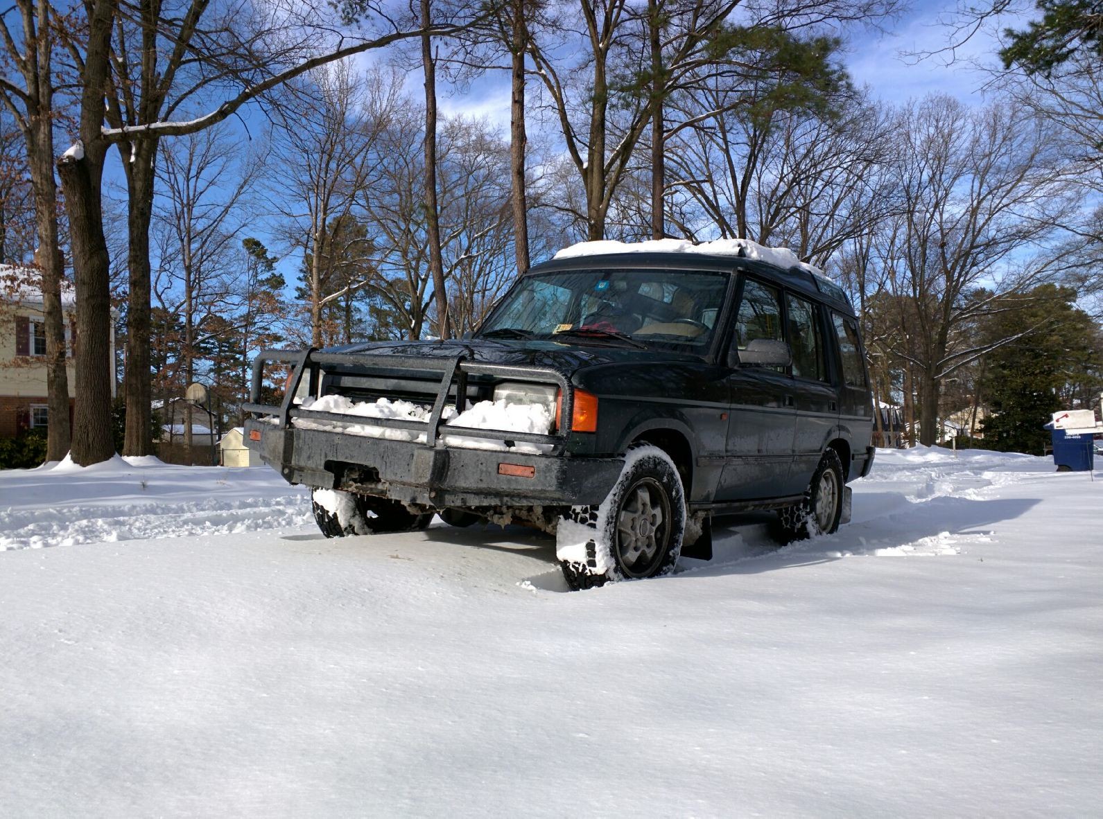

Also I usually keep her really clean, however, we have been hit with some serious snow recently. Had a lot of fun with it in the snow.
