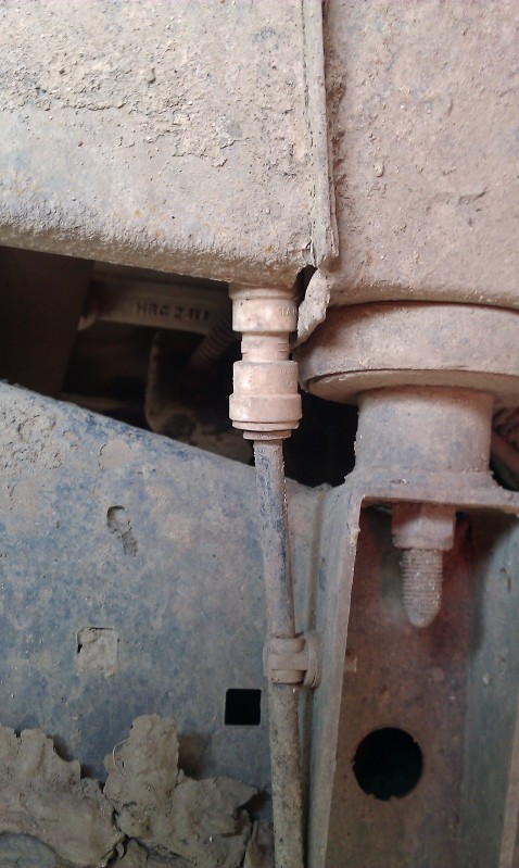

You can extensd the breathers with fridge line. I used a $2 fitting from home depot for mine.
