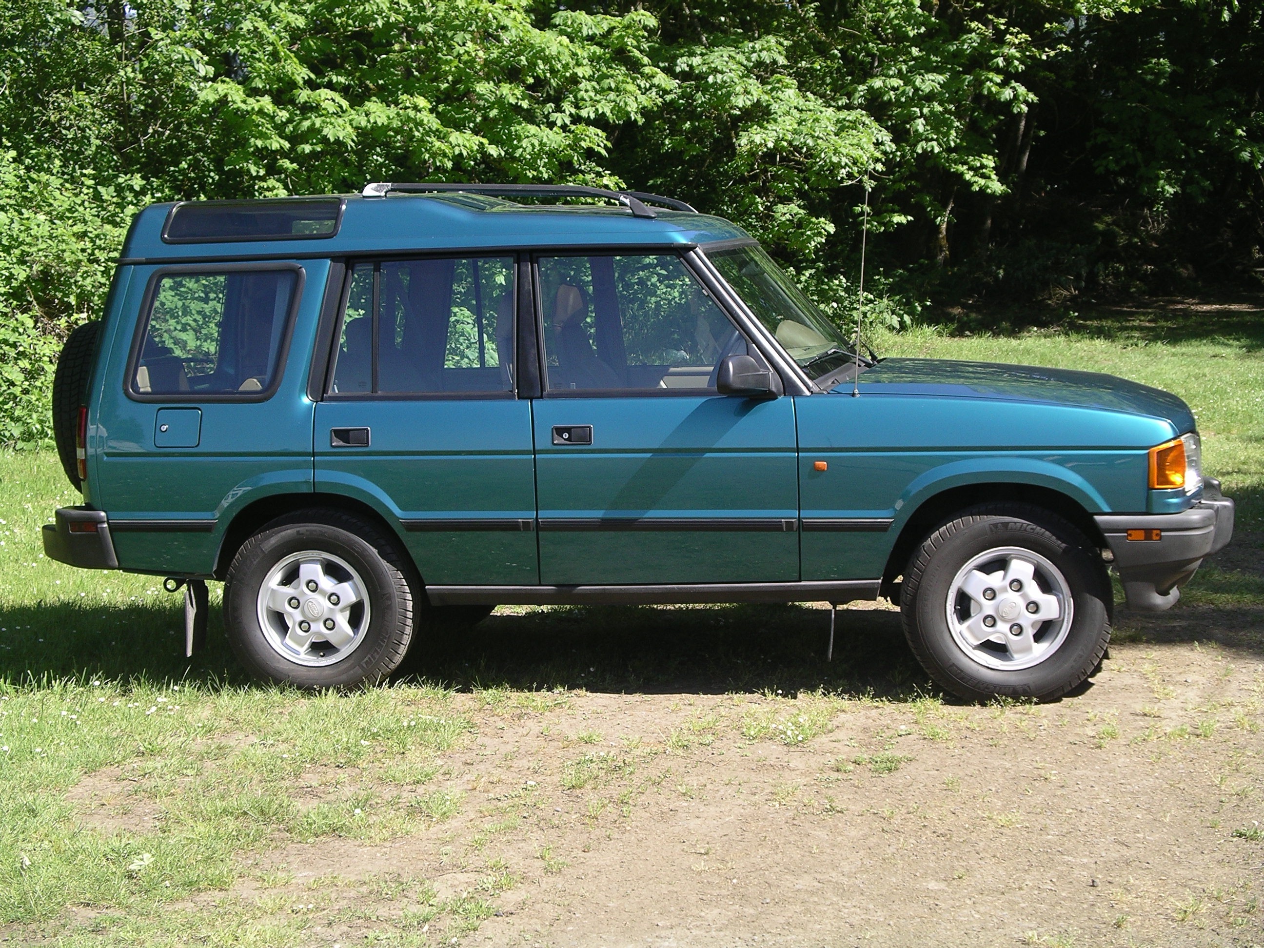

Hmmm-- will do the cable to box cleanup. Did clean that ground connection, but did not go from there to the box. Need to borrow tester. This is an excellent Rover truck that fell into very unskilled hands. We WILL get it back up to speed!
