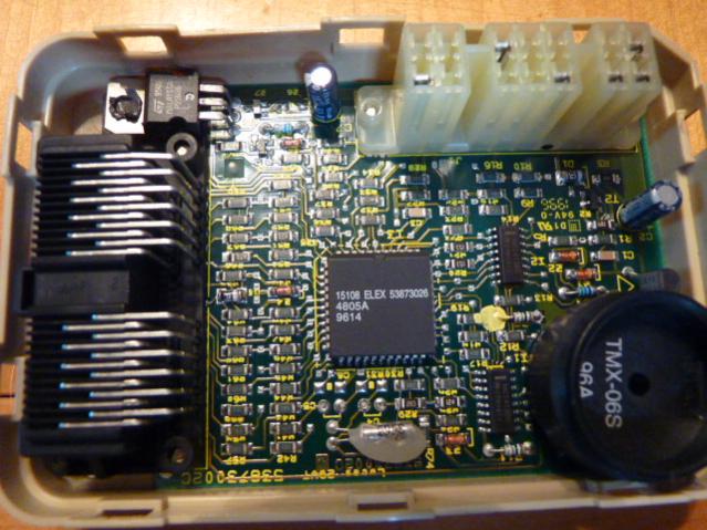

Have seen some posts about this but no definitive solution. With my 96 Cherokee it was just a matter of pulling out the sound box and the annoying buzz was no more. Please tell me it's as simple on a 98 discovery? This beep is way too loud!

I think it is the multi function unit (MFU) which os a small box on back of fuse panel under dash. Controls lots of things, has a sounder inside.

You will usually find prompt results on this forum, no need to wait a week. Here is a pix of the circuit board inside that device, the round thing lower right is the sounder. Some tape will mute it.
