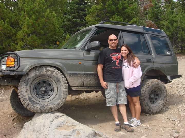

I ran 285/75s and 305/70s on mine with 2" RTE springs. I cut the fender back to radius line of it and ran 30mm spacers on it. Daily driver, rock hopper and ice racing rig. I loved both of those setups.
Old Mar 16, 2022 | 02:49 PM
CbIdrive's Avatar
Joined: Oct 2018
Posts: 11
From: Parker, ColoRado
285/75 with trimmed fender 2" RTE lift
305/70 same lift before fender trim
