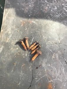

Step 1:
Check the top of the fuel pump for leaks
Of course the screws holding the plate to the floor were completely corroded. Luckily they are screwed into plastic so they did come out with a bit of chisle work and sole locking pliers.
turned on the key and gs started sdripping, bu the pump area stayed dry. so next we go underneath...
